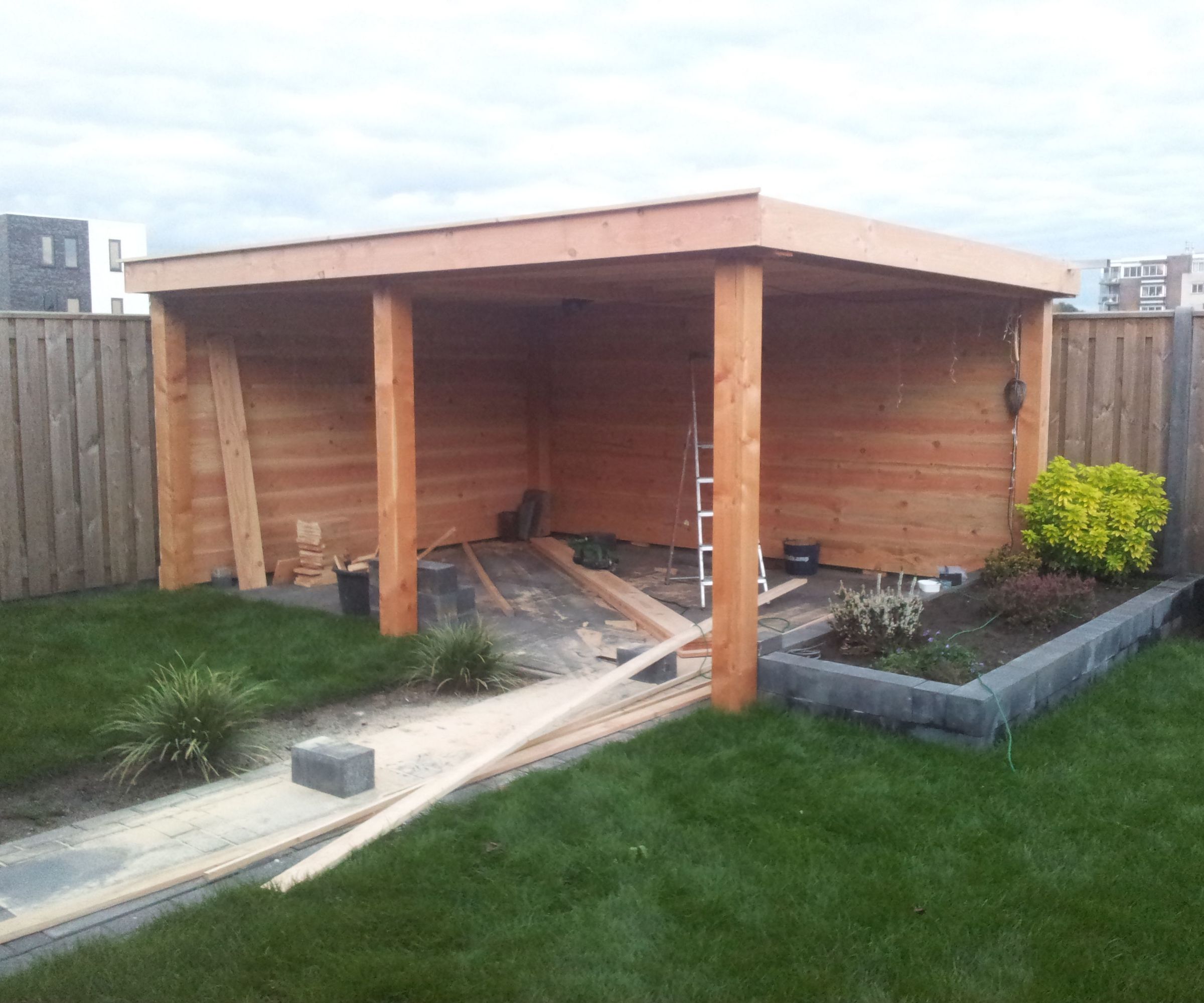

Introduction: Patio / Terras Fireplace
In this instructable I'll explain my adventure making a fireplace in my garden patio. The steps involve a bit of metal fabricating and some unconventional ways to make your own double-walled or double-jacketed chimney pipe. Playing with fire is a lot of fun but can be dangerous. Please note that I tested my setup at different stages throughout the building process. Whatever I came across that deemed unsafe to me I improved in my own way. I like to make things cheap or for a fraction of the costs that you would be paying normally. Still some parts I made for this build are perhaps better bought in quality store. And some jobs of this build are perhaps better left to a real professional.

Step 2: Setting Up the Fireplace
The next stage is to install the fireplace at the right spot, making the surroundings fireproof and installing the chimney. Chimney piping is super expansive especially when you want it double-walled (double-jacketed). The top part alone (the part on top of your roof) costs about 700 euros. I avoided this by making my own piping. I tested this and it's all safe and sound although it's a bit unconventional. Note that I gave my chimney and end cap a few coats of fire resistant black spraypaint.
Firstly I put the fireplace on a base at the desired height. I used a few blocks of stone left over from a planter box I made earlier. I didn't fix this in place because the ornamental stones I would be using later would hold it all together.
When I was sure about the right spot (and got full approval of the missus) I started cladding the walls with heat resistant boards.
Then I installed the chimney. I used a rope and a heavy nut to pinpoint the hole that needed to be cut in the roof. I made the hole a bit bigger than the diameter of the chimney. It's important that the wood doesn't touch the piping so I left a 2cm wide gap between the two. To brace the chimney I used the heat resistant board. I cut out a two 50x50cm squares and made a hole in the middle through which the piping fits pretty snuggly. I screwed one board directly on the ceiling of my roof exactly underneath the premade larger hole. The second (duplicate) I screwed down on top of my roof. Then I could run the chimney through it and down on top of the fireplace.
To be sure this was enough to prevent dangerous situations I tested the fireplace while drinking a few beers with me mates. It turned out the chimney got red hot just above the fireplace and overall it wasn't really safe in my opinion. To fix this I took a smaller diameter spiral pipe and fitted it within the chimney pipe to create a double-walled or double-jacketed pipe. I used small blocks of heat resistant board as spacers. After I put the pipe in place I filled the gap between the pipes with play sand from my kid's sand table. This acts as an insulator. Now I am able to touch the chimney without burning my hands immediately.
Lastly I glued on the EPDM rubber on the roof to close gap between the chimney and the roof. This was a messy job and definitely not the best way to go about but it worked for me. I used heavy duty sealant for this. I also put a small cap on top of the chimney to prevent rain getting in. In the last photo of the chimney you can see the cap. There is only 3cm of clearance between the cap and the chimney. I later put the cap on a bit higher so the clearance was about 7cm. This greatly improved the smoke being pulled through the chimney.
