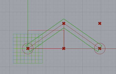

Step 2: Draw Unit Cell
This step can be done outside of grasshopper, but my first pattern is a zigzag, so I programmed it in grasshopper so I could easily change the aspect ratio of my zigzag.
I will attach the entire script at the end, but here is the part of my code that generates one unit.
Step 3: Cutting Holes
I used Rdif (region difference for this step). First, I generated the start and end points of each line segment using Endpoints (End) and used those points as the center of each circle. I selected the radius to be slightly larger than the offset distance so the shapes don't touch in the array.

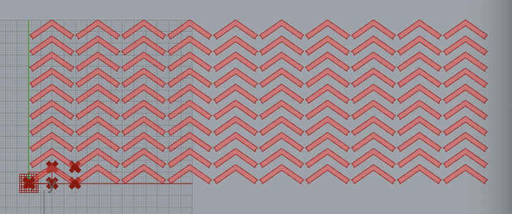

Step 4: Tiling for an Array and Extruding to Make a Solid Object
I used a rectangular array to start, and made a 10x10. Then, I capped it to make the object solid, and converted to a mesh. Then I Baked and exported the file into my slicer for a Print. Due to time constraints, I only Printed a 2x2 array, but pattern generation was the focus. You can also define an array along a curve, or a polar array.
