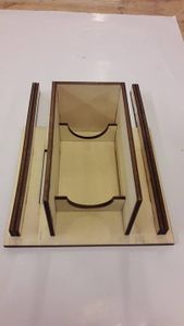

Take the base plate, and install the two sides and the back into the slots with wood glue (1).
Step 4: Supports and Rails
- Step 2
Place the supports of the glass into the wooden tray and fix them with wood glue. (2)
If you done this, you need to glue the patterns on each other. So you get a piece of 10 mm thick. It is necesarilly that you put the patterns perfect in place. Use some clips to do that.
Take than the two long flat patterns. You need to install them onto the baseplate (on both extends ) with wood glue. (3)
(4) is the end result of the first subassembly.

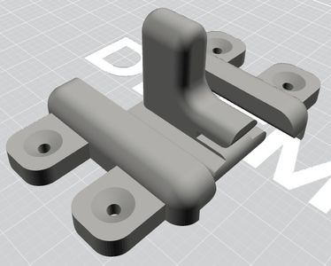

In attachment you can find the 3D files to print.
You need to print:

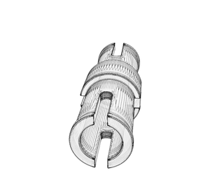

- 6 fingers houlders
- 2 rails
- 1 component to fix the glass. The radius where you need to put the glass in, is the same as our glass we used. So if you chose another glass, you need to chance the radius.
Step 12: Place the 3D Printed Parts
- Step 9
When you printed the 3D parts, you have to place them on the base plate. On the base you can see four holes. These holes match with the holes of the two 3D printed rails. To connect it with the wood, you can use screws and some glue.
Make sure that the rails are open in the direction of the glass.
If you have done this you can place the glass fixer. Normally it passes good between the two rails.
