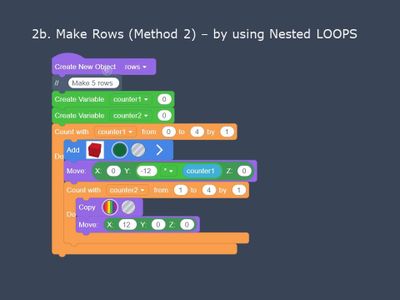

Step 2: Make 6 Rows of 5 Cubes
Look at the animation, and try to write the codes by using the following techniques:
- REPEAT LOOP
- REPEAT LOOP and TEMPLATE
Please consider the following information in your programming:
- Make the cubes W=10, L=10, H=10
- The distance between cubes is 12
