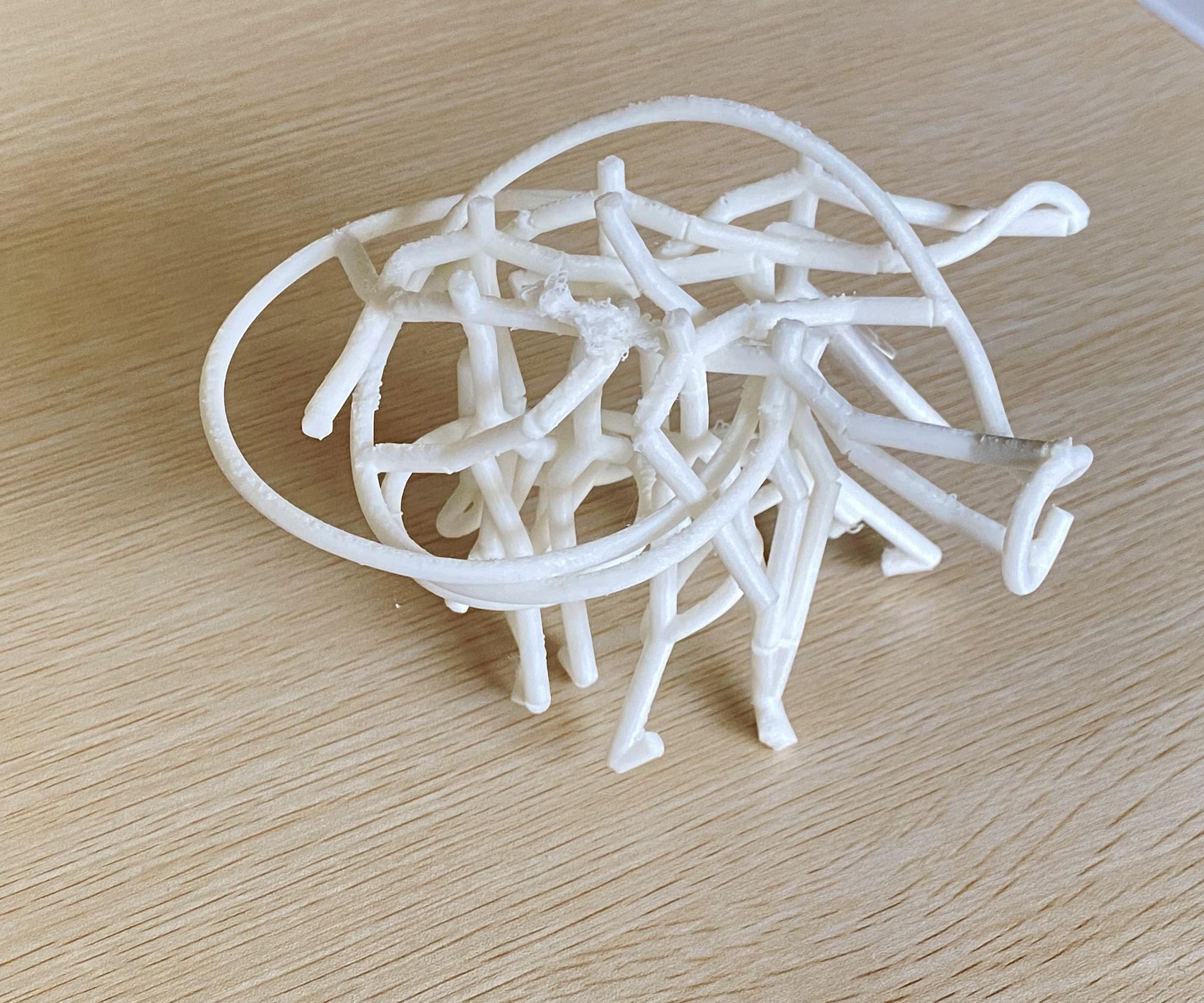

This tutorial is about how to make 3D-printable ornamental grid object with Rhino and grasshopper. The example made with this method is shown above.
Assuming you have some knowledge of Rhino and Grasshopper, I am explaining the workflow of creating these 2.5-D object.
The 2.5-D object is basically created by extruding a 2D pattern along with the Z-axis(vertical). The entire process is done within Grasshopper, and can be divided into four steps:
