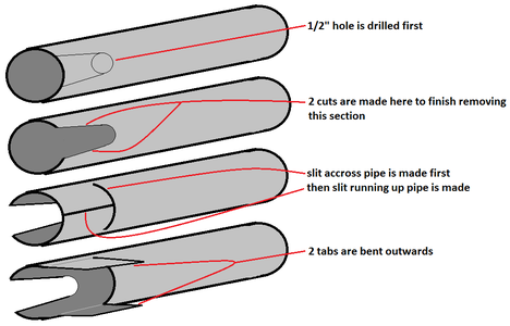

Step 4: Build the Feed Tube - HOPPER
- Insert your tube into the hole and center it the best you can.Grip the tube and while pressing down rotate it back in forth.The act of the downward pressure and rotating will burnish the plywood underneath it slightly, marking exactly where the tube will land.
- Take a sharpie and mark where you are planning on placing your solenoid and where the ejection chute will be.
- Pull out your tube and stand it up on a level surface, place the solenoid beside as you would in the box and mark off the top of the solenoid plunger
- Drill out this mark, ensure it is just large enough for the plunger to clear
- Notch out the bottom of the hole
- On the reverse side cut a T into the pipe, when you unfold the metal it should be large enough for your biscuit to slide through easily. - See pictures
- At this point you can if you so choose add the hoppers PEEP holes. I just chucked it in a vise and used my drill press. The holes are spaced about 1 1/2" apart, this is horrible to admit but I didn't measure it, just drilled the holes free-hand. I am my own worst enemy sometimes...
