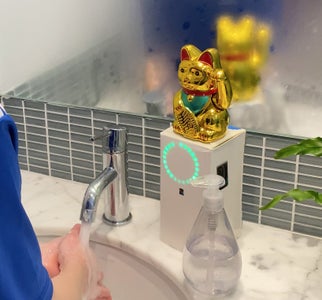

Since we are all distancing at home, Paws to Wash is a DIY project that guides parents and kids through the process of building a cute feedback timer with a waving cat to encourage healthy handwashing habits.
In the time of Covid-19, washing hands thoroughly is essential to keep our families and communities healthy. The research also shows that few of us pause to wash properly every time. Let’s give ourselves a little ambient feedback with light, sound, and cuteness.

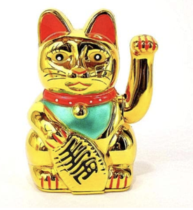

The project is inspired by Maneki-Nike, or the beckoning cat – a Japanese good luck talisman. According to folklore, it sees the future and washes its face just before your guests arrive. The arm action indicates washing –and you should too!

Plug your USB cable into the Nano, and upload the program onto the Nano. You should hear some clicks from the speaker and the Nano’s LEDs will flash. Eventually, you should see the stable LED pattern below, which indicates the Nano is waiting to see a proximity sensor event.
Step 4: Build a Base
We found a milk carton, turned inside out was a great waterproof base for our project. Just tape the light ring behind the front face; the LEDs are bright enough to shine through. Make a hole so the proximity sensor can peer out to see your hands as you reach for the soap or faucet. Remember its range is only around 5". We didn't decorate ours, but you could. Write something like "20 seconds for 5,000,000 germs per hand" or "don't forget your thumbs".
Step 5: Install and Wash
Set your animated cat on top, and position it to start when you reach for the soap. Now see if your family is better at washing their hands for a full 20 seconds. Share a picture or video of your project with your friends on social!
