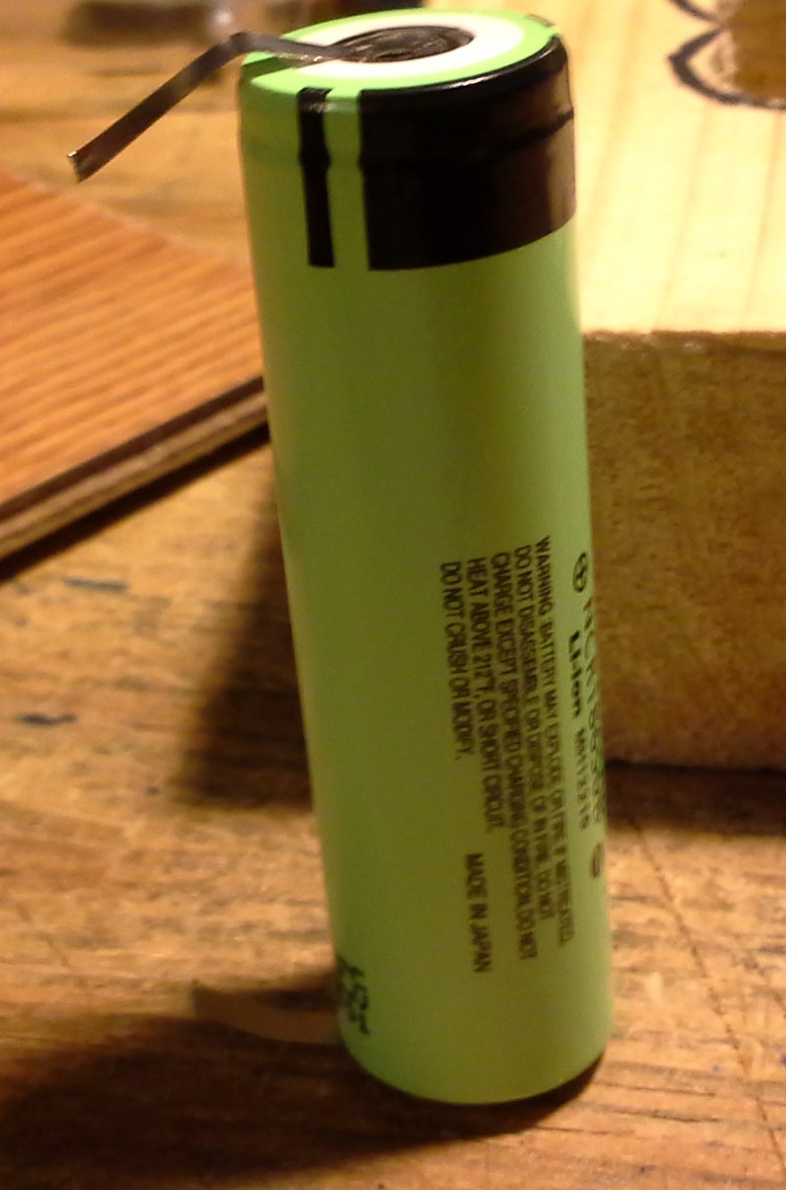

- Replacement 18650 Lithium Ion battery with pre-welded tabs
Pre-tabbed NCR18650B are available here (xpresstekstore.com)

For a replacement, I used Panasonic NCR18650B 3400 mAh battery. This cell had the solder tabs spot welded on in our shop. The tabs are thinner and narrower than standard weld tabs in order to match the original.
Solder the wires to the terminal tabs only.
Do not solder directly to the battery!!!
