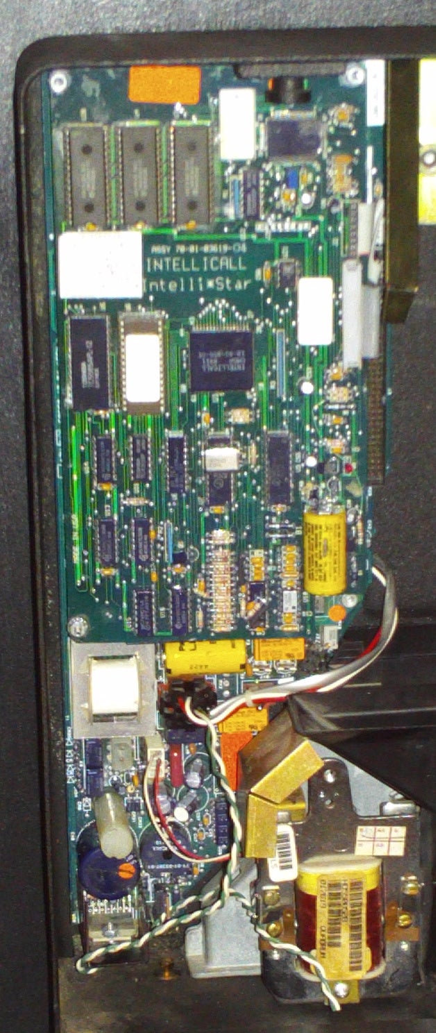

Step 2: The Guts
Like I said mine was used so of course it suffered many hours of use and abuse. Luckily mine
survived with only cosmetic damages such as chips in the powder coat. Once armed with my
trusty can of spray paint, and screwdriver I set off to work. This pay phone is consisted of only
a few major parts, such as the Smart board, cash box, the keypad, and the coin verification and
relay circuits. The seller had included keys to all three locks, the faceplate and the cash box.

Step 4: The Smart Board
The Smart board basicly decides how much calls cost and controllers coin verification relays.
There are 3 main maker of these board and they vary accordingly
1.Protel
2.Elcotel
3. Intellicall
Mines a Intellicall (aka. ultratel)
It requires a 24v@ 1.6A transformer, majority of them run off line voltage and a two pair phone
line for voice data. Programing can be done for Intellicall via Inet board or the phone line from the
company. The Protel board can be programed by pushing a button and a series of numbers
for each type of call.

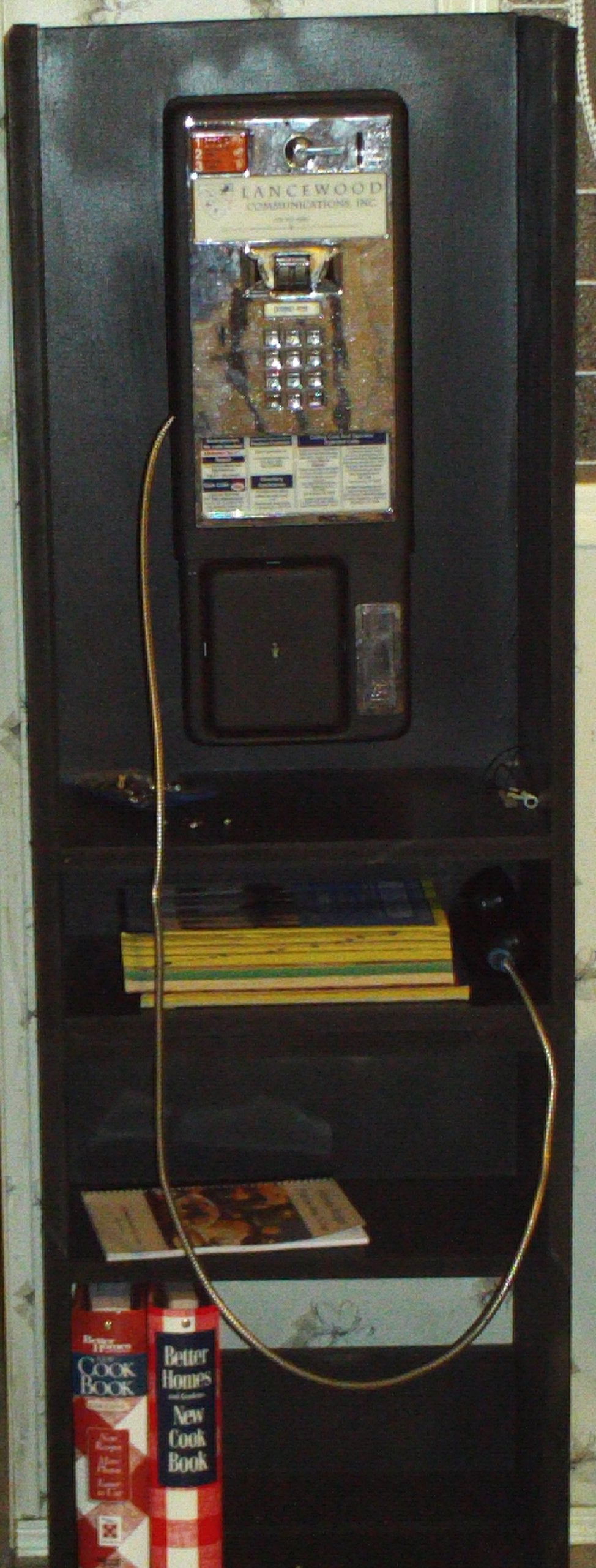

Step 6: The Booth
Typical pay phones either require a backing plate or a enclosure due to the fact that they weigh at
least 45 lbs. This weight would destroy wallboard. I found and chose a simple indoor enclosure
and built it on top of a shelf versus hanging on a wall, I replicated it myself. I chose to use 3/4"
mdf which I found to be rather sound material. But I would recommend using mdf screws they
grind through and prevent splitting when drilled in slow. As far as paint, flat black paint as always
and I attached the phone with bolts. Add power and phone line, program the smart board and
presto you have dial tone.
