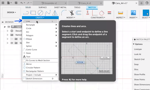

  • Now we look for where it says "CREATE", click and then "MIRROR". There we have 2 options, "OBJECTS" and "mirror line", press "OBJECTS: SELECT” and choose the lines (28mm and 3mm) that we have created.
Those will be the lines we want to mirror.
  • Now click on "MIRROR LINE: SELECT”, and choose the guide line that we had created, and click "OK".

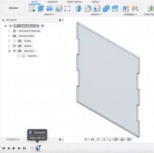

  • If we do not observe the rectangles, what we will do is to press the icon "EXTRUDE 1" (shape of a cube) at the bottom, right click and press "EDIT FEATURE”, select the rectangles and press "OK".
To give volume we click on "CREATE", and then on "EXTRUDE" we give it 3mm of thickness.
  • COLOR: To give color we must click on "MODIFY" at the top, then on "APPEARANCE", you choose the color you like. In this case we use "GLASS - LIGHT COLOR (BLUE)",
And put save.

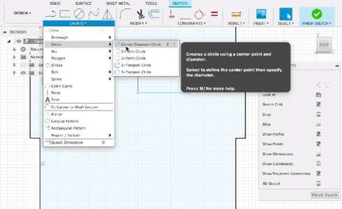

  • In order not to make a mistake we will delete the 33mm guide line, then we select "CREATE", "CIRCLE" and click on "CENTER DIAMETER CIRCLE", we will create 2 circles in each corner of the 15.75mm line (circle measure is 3mm). Finally we remove all the guide lines we already used and click on "FINISH SKETCH".

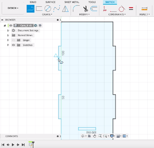

  • For this face we will do the same process of creating sketch, this time the axis will be (X, Y). we save it with the name "SIDE C".
Step 10:
  • We will start again using "LINE", starting from the intersection, a horizontal line direction to the right (measure of 24mm), the second line will be down (measure of 3mm), the third line to the right (measure of 24mm), the fourth line up (3mm) and so on until we reach the fifth line that has had measure of 24mm.
  • At that point a line is made upwards (20mm measurement), then a line (3mm) to the right, another line upwards (20mm measurement), another to the left (3mm) and finally a line upwards (20mm measurement).
  • Now we will create a guide line at the midpoint in the right direction of the second vertical line measuring 20mm, then use "MIRROR", click on "OBJECT: SELECT" and choose the lines that are close to the X axis (the 24mm and 3mm lines) and click on "ok".
  • We will create another guide line in the middle point upward direction, on the second horizontal line at the top (the 24mm measurement line), select "MIRROR" again, choose the column on the right side for "OBJECT: SELECT" and choose our last created guide line for "MIRROR LINE", click "OK", delete all the guide lines we have already used and press "FINISH SKETCH".

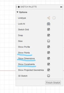

a) If you are uncomfortable with the points, dimensions and measures on the right side there is a "SKETCH PALETTE" list where you can remove them by pressing the "show point, show dimensions and show constraints" checks.

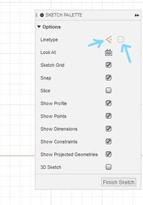

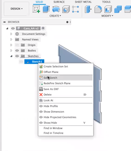

b) When you create the guide points you can change the type of line to differentiate from the others, this can be done by going to "SKETCH PALETTE" in the "LINETYPE" part.
c) If you want to edit in your plan you can do it by going to the top left, select where it says "SKETCHES" with the right mouse click and select "EDIT SKETCH".
