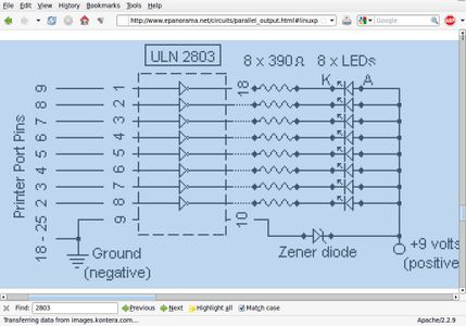

We can use programs such as parcon to set values at the parallel port for such jpbs as controlling the power train. see also: https://www.instructables.com/id/Mini-parallel-port-break-out-cable/
https://www.instructables.com/id/No-solder-parallel-port-break-out/

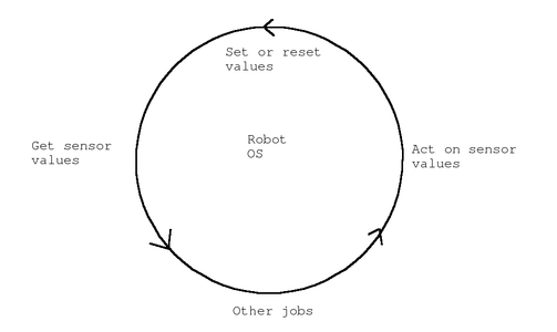

Robot os. The infinite loop.
While true%
' set or reset values
' input sensor values
' Other jobs
' Do what is needed based on input values.
wend
