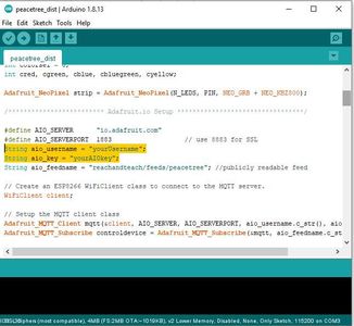

Step 4: Load the Peace Tree Code on the Huzzah
If you haven't loaded code into the Huzzah ESP8266 previously, check out https://learn.adafruit.com/adafruit-huzzah-esp8266-breakout/using-arduino-ide for instructions on how to do this. In particular, you will need to install the Huzzah library. You will also need the following libraries: DNSServer, ESP8266WebServer, WiFi manager, and adafruit_mqtt and adafruit_mqtt_client.
Now find the distribution code for the Peace Tree at: https://github.com/reachandteach1/peacetree , unzip the repository and open peacetree_dist.ino .
Before you can compile and load the code, you will need to modify the following lines of code:
String aio_username = "yourUsername";
String aio_key = "yourAIOkey";
with the username and key you established in the previous step at io.adafruit.com
After you make these changes and save your code, you are now ready to compile and upload the code to the Huzzah. Make sure you have selected the correct board (Adafruit Feather HUZZAH ESP8266) and correct port number for the USB cable you are using to connect between your laptop and the Huzzah (this should be auto-detected but you will need to explicitly select the port.)

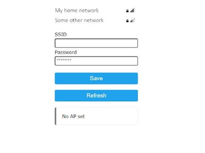

Step 5: Connect the Peace Tree to the Internet
Finally, you will need to configure the WiFi network access to your network.
After applying power to the Peace Tree, you should see a network connection called BobbleConnectAP on your phone or laptop. Connect to that connection with the password "password". Your browser should automatically connect to a configuration screen. If not, open your browser and connect to 192.168.4.1. Click configure WiFi, scan for your own WiFi network, and enter your network's password. Your Peace Tree should produce a brief pattern of red lights followed by green lights. That should be all you need to do.
The Peace Tree should start blinking in less than 5 minutes, but if you are impatient you can navigate your browser to http://www.reachandteach.com/peacetree144.php .
