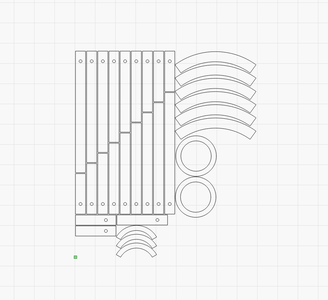

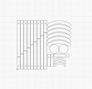

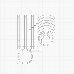

Step 2: Convert SVG to DXF
After designing all things and assigning color as you want, we need to make a .dxf file for Lasercutting.
First, we export a red color design. we hide other color designs and use export>.SVG file.
Do this step for another color.
For making .dxf file I use a cloud converter to convert SVG file to a DXF file.
https://cloudconvert.com/svg-to-dxf
I also add my files for direct use.

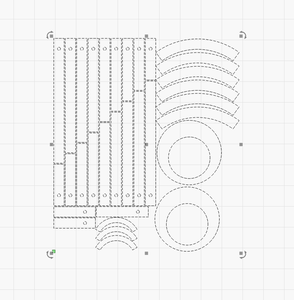

Step 3: Laser Cutting
I have a 100w co2 laser cutter.
I use 2.5mm Acrylic in 5 different colors.
Use power 50 and speed 15 mm/sec.
