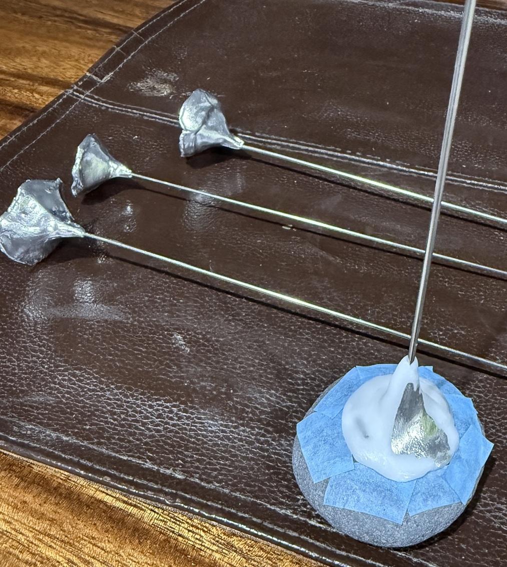

Step 2: Making Pebble Holders
Follow the instructions for the moldable plastic and place the beads in hot water until they soften. Take a small amount and shape it around the connection between the pebble and the support end of the wire. The shape should look like the images shown. Depending on the pebble’s shape, this may be sufficient to bond the pebble to the wire, or you may need an additional step using liquid nail for extra security.
Protect the area with masking tape as shown, and finish by coloring the supporting plastic with a chrome marker.
