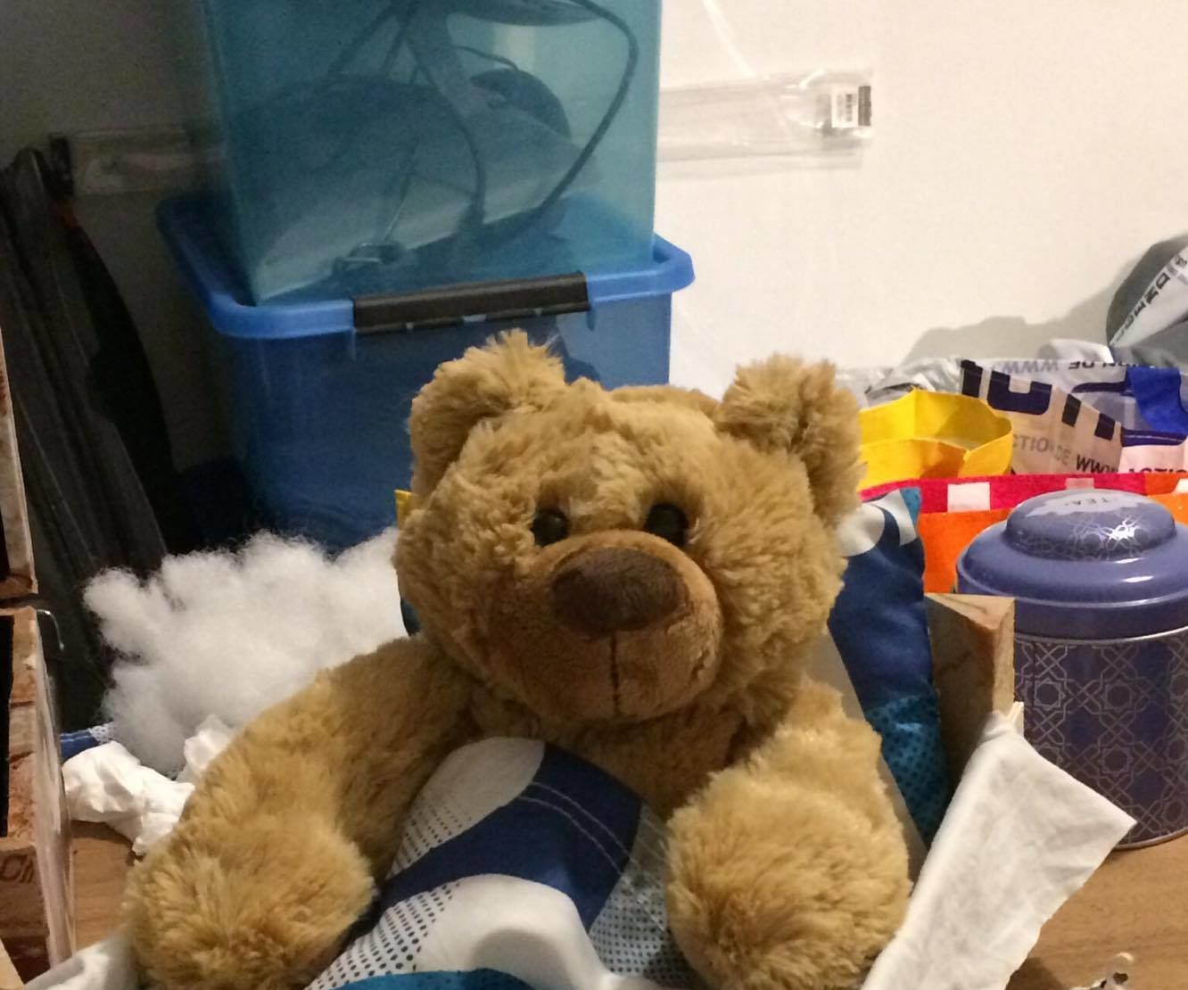

Step 2: Designing the Arduino Uno Hardware
I started with hooking up the Buzzers first.
For ease and having it as 1 component I took the Tiny Breadboard (Extra Small), and put them on the breadboard. Together with the power and the port cables I connected them all in a matter, so I knew which color belonged to what Buzzer.
Next up I took the Large Breadboard (I know.. Such an overkill)
I put the button on it and started connecting the resistors(its a 100 Ohm Resistor)
And connected both port ground and power to it.
Step 3: Putting the Arduino Together
I used a slightly different buzzer in the pictures but its basically the same one.
As you can see I hooked up the buzzer without a resistor since a resistor will tone down the volume by a large margin. All power cables go into the big breadboard where it gets 5v and Ground if necessary

Step 4: Putting the Arduino Together P2.
As you can see the button on the Large Breadboard is the same as the schematic I drew out in my design.
It also goes towards the Arduino so it can be used in the future of this Instructable

Step 6: IT WORKS!
Now lets put this Arduino into the bear and it ready to be used.
Now you can easily put your children to sleep! Just make your kid hug it and it will play the tune you want
I chose a song from the Dutch Amusement Park attraction called "Vila Volta", well I tried at least haha.
