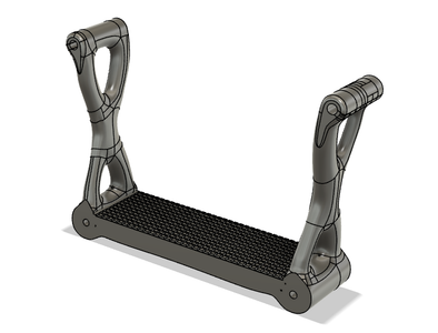

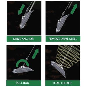

All parts are designed in Fusion 360, and several of Fusion's specialty features were very helpful to create the organic feel that I was aiming for. Both the generative design and Automated Modelling features were very helpful. The design is intended to be 3D printed as a final production method on a large scale printer, and it was designed to accommodate the limits of additive manufacturing. It is designed to be printed on its side, which limits the amount of support material necessary and orients the layer lines parallel to the direction of bending under load, maximizing strength. The knurled pattern increases traction and helps prevent becoming a slippery surface in the rain. The rope bridge design and natural shapes are supposed to feel at home in a forest, and as such one of the goals of this project was to make installation as simple and noninvasive as possible, so as to not disrupt the natural environment. The four supporting posts will have to be poured in concrete, but the cables themselves will rely on large ground anchors, which can be set deeply in the ground without disrupting plant life.

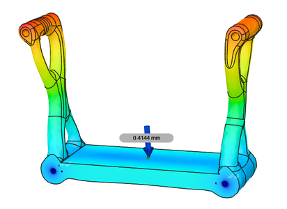

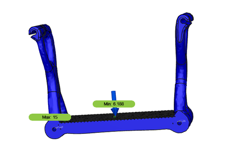

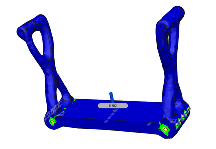

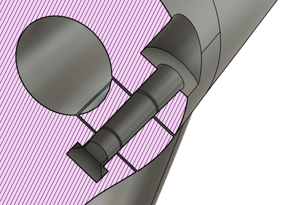

Fusion's simulation feature helped me determine the ideal material for the bridge, and test how the materials would test under load at different temperatures. These simulation led me to choose polycarbonate as the material of choice, because of it's better heat resistance compared to ABS. While polycarb is hard to print, additives like carbon fiber can be used to reduce warping and slightly increase strength. As well as simple installation, another focus of this design is is simplicity in repair. Each track for the cable is bolted in place so that damaged bridge sections can be removed and new ones installed without removing the other sections or the cable. These bolts are threaded into captive nuts that are inserted during printing, another freedom that additive manufacturing affords. Originally I thought that adding rebar across the length of each bridge section would be necessary to stiffen it up, but the simulations showed only marginal improvements to the safety factor (from 6.188 to 6.752) and so the rebar was deemed unnecessary.
