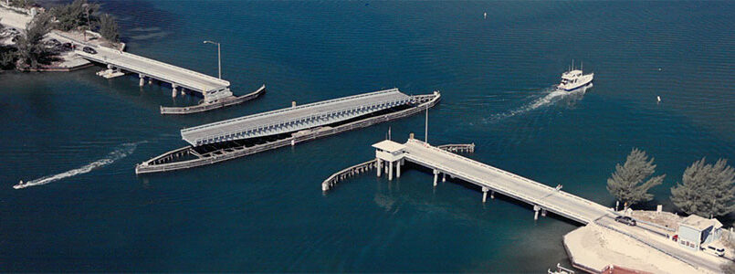

One solution to the problem of having to allow ships to pass through my bridge led me to research. After looking at other bridges on Staten Island I realized that building a swing bridge would be a good solution. I decided to go with a turning style swing bridge rather than one that lifted 2 wing to allow for ships to pass.

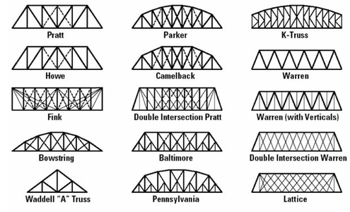

Since I was building a swing bridge that turned, I had to design a type of bridge that would hold up being held from its center. If I just build a long road over the main turning mechanism, it would just fall apart. I looked at swing bridges around the world and determined that a truss bridge that was taller in the middle would hold up better than other types of trusses. A bridge type like the camelback would be well suited for a swing bridge. The reason why I had to create the bridge so long was to enable the wide cargo ships to pass through which sometimes were well over 30 meters long.

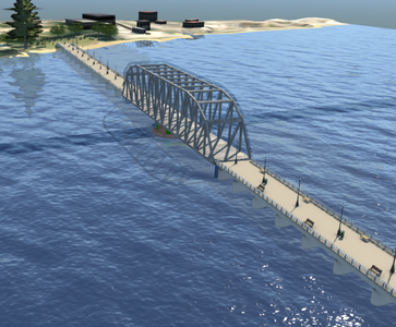

For the first step of my swing bridge, I designed the actual bridge that would go on top of the turning mechanism of my bridge. For this, I used Autodesk inventor, since I already had some prior experience using the program.
I then used a stress analysis to determine the integrity of my bridge. I created fixed points at the center of my bridge where it would be held and tested it using the force of gravity.

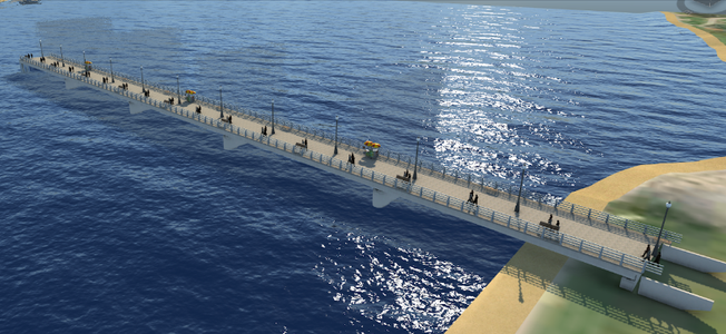

Step 8: Creating Connecting Piers
Since the river that I was building my bridge over was over 400 meters long, I could not just build a swing bridge that was 400 meters long which would not make as a good pedestrian bridge. Instead I would create 2 piers on both sides of Staten Island and New Jersey which people could hang out on. I used Autodesk Infraworks to create the 2 piers and edited and modified them to fit a more pedestrian style pier. I added benches, hotdog stands and lamp posts as decoration.

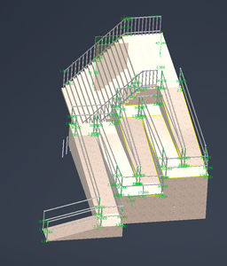

I also created designated stairs for the bridge on both sides. I also created ramps for people in wheel chairs so that they could also get on the bridge. I created these stairs and ramps in Autodesk Inventor and imported them into Infraworks.
