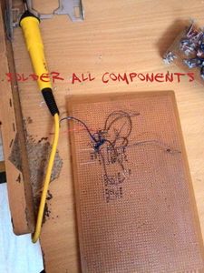

- Take a vero board, and first assemble 4093 IC and then other IC according to systematic.
- if you want to make a printed circuit board. i also upload actual size pcb design and component layout.
- add tilt sensor .
- add resistors
- add capacitor.
- now add 7-segment display.
- do not attach (reset) and ( display) switch on board, because it attached on plastic box. these switch install later.
- solder components, according to given systematic.
