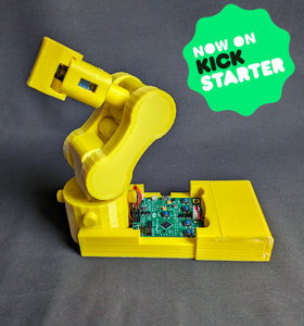

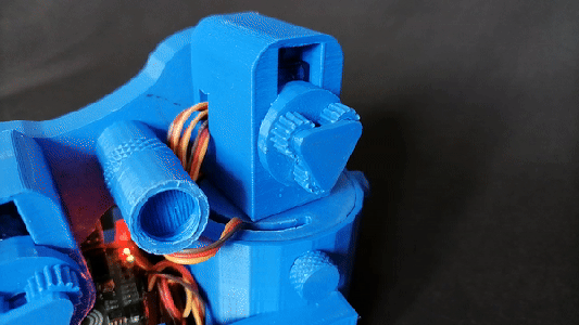

Step 1: Planetary Gear Systems
Assemble the three planetary gear systems as shown, and verify the rotation of each.
Step 2: Board and Battery
- Place the Pedro board on the base and connect it to the battery.
- Ensure that the board powers on.
- Insert the servomotor for the base rotation and connect it to pin D5 on the board.
Step 3: Forearm
Insert the second servomotor into the elbow piece and the third servomotor into the gripper piece. Then, connect the elbow and gripper using the link arm piece, as shown.
Step 4: Arm and Forearm
Attach the forearm to the upper arm by connecting the elbow joint to the shoulder piece as shown.
Step 5: Assemble Gripper
Mount the two planetary gear systems onto the elbow and shoulder servomotors. Then, attach the gear arm piece to complete the assembly as shown.
Step 6: Gripper
Attach the gear to the gripper servomotor, then position the two gripper pieces as indicated.
Step 7: Arm Suppport Base
Secure the support base to the arm beneath the elbow piece with screws.
Step 8: Connect Arm and Base
Complete the arm by covering the side with the servomotor cables, then secure the arm to the base with the four screws as shown.
