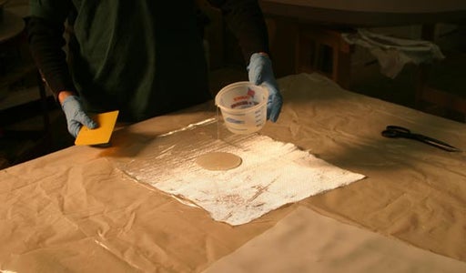

Step 2: Apply Fiberglass

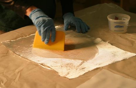

Step 3: Wet Out Fiberglass

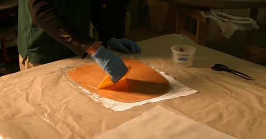

In order to get your fiberglass “wetted out” in one shot, you’ll want to use a little more epoxy than you usually do for a first coating. About 15 to 20% more in our experience.

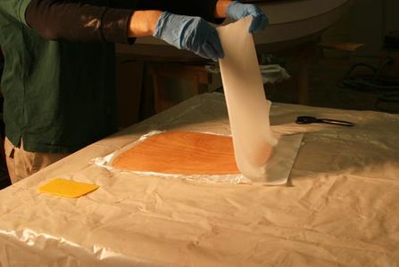

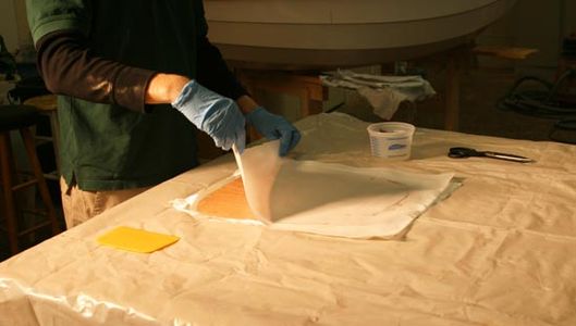

Step 4: Add the Peel Ply
When the fiberglass has gone clear and is thoroughly wetted out, add the peel ply.

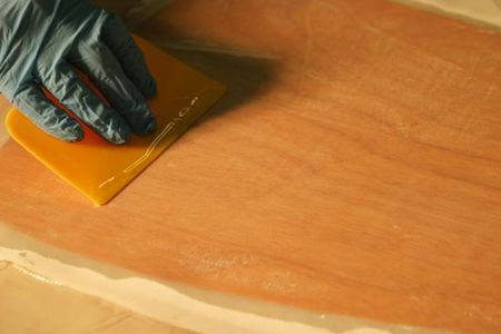

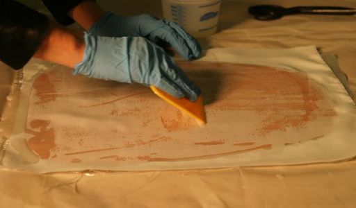

Step 5: Smooth the Peel Ply
Smooth the peel ply with your plastic spreader.
Step 6: Eliminate Bubbles
Look for a consistent dark color; white means you have air trapped under the peel ply.
Let the epoxy cure.

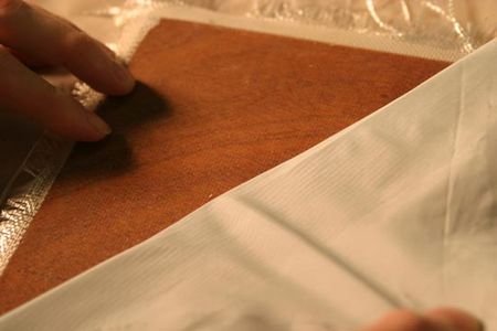

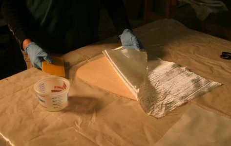

Step 7: Peel Off the Peel Ply
Peel off the peel ply. You should have a near-perfect surface. If you’re varnishing, you’ll still need to sand thoroughly with 220-grit.
