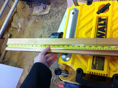

Step 1: Parts
I used a bucket about 5 liters in size, 18cm tall.
I found a scrap board about 75cm long 2cm thick and 8cm wide. I ran it through the planer to clean it up a bit.
I wanted a board about 3X longer than the bucket was tall and thick enough to support a pin for a hinge.

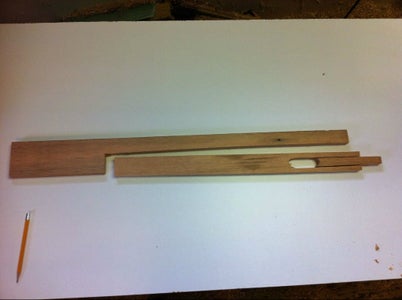

Step 2: Cutting Out the Board
As this is not a fine tuned instrument yet there are no set measurements at this time.
I do know that by changing the length of the neck you can change the tone because it changes the length of the string. The type of string you use will also make a difference so try some different types.
Cut out the neck and drill a hole where you want the bottom of the fork to be. The hole should be slightly larger than the wood is thick so the head will have some space on either side, you don't want a tight fit. Cut down to each side of the hole from the end to make the fork.
Drill a hole across the forks where the screw/hinge pin will go. Make sure the screw threads can still get a grip.
It is not really needed but because of the type of rim that the bucket has I tapered the bottom of the neck so it would fit into a slot in the rim.
I then used the scrap from the fork inside the bucket as backing to screw the neck onto the side of the bucket. Make sure you do a better job of pre drilling than I did.
