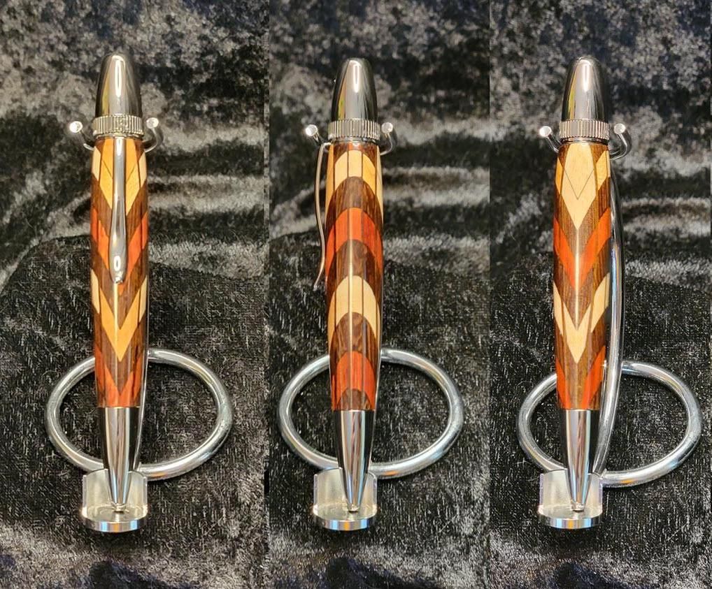

Make as many copies as you like. For the demo I simulated 8mm to 16mm pen barrels in 1mm increments. The 16mm barrel models a Guardian pen. The 14mm would be a Guardian Jr. or a Cigar pen. Lots of pens come in around 12mm - Vesper, Duraclick, Compson, etc. Down in the 8mm to 9mm range are Slimlines, Concava and so on.
The second photo compares the visualization on a 12mm barrel with a finished Compson pen.
