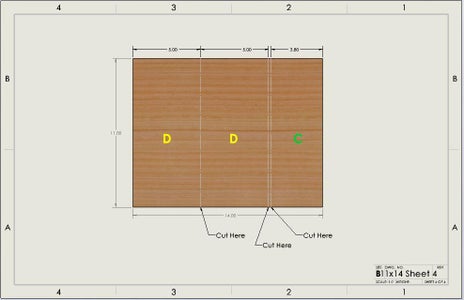

Step 1: Cutting Wood Pieces
Above are my suggestion on how to cut your wood pieces to save material.
If the pictures are blurry download the .pdf attached below.
Note: Make sure you are using the right piece of wood since there are two sizes of panels. On the bottom right, it tells you what board you should use.
Before starting to cut always measure twice before cutting.
After cutting all the pieces as instructed on the pictures, now you should have the following parts:
  • 2X Part A ( 4" x 12" ) Side Panels
  • 1X Part B (11" x 12") Back Panel
  • 1X Part C (3.8" x 11") Bottom Panel
  • 3X Part D (5" x 11") Layers
  • 3X Part E (3.5" x 3.5") Right Triangle
