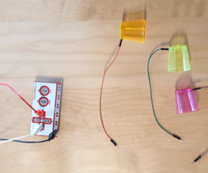

Step 4: Connect the Makey Makey
Use alligator clips to connect the foil rectangles to the Makey Makey and connect the larger piece of foil to earth.
Put everything on the ground so you can use your feet to play the game.
