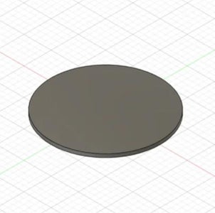

Step 1: Creating the Base of the Holder
Start a sketch on the top plane. Click on the origin and create a cylinder. Make the diameter 100mm, and set the height to 3mm.

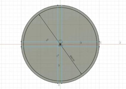

Step 2: Split the Base Into 4 Compartments
Create another sketch, but this time, on top of the cylinder. Sketch a circle with a dimeter of 94mm. Draw 2 horizontal and vertical lines, but extend it all the way to the end of the bigger circle. Dimensions the horizontal and vertical lines to be 2mm apart. Finish the Sketch.

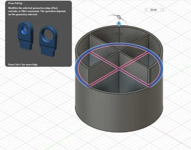

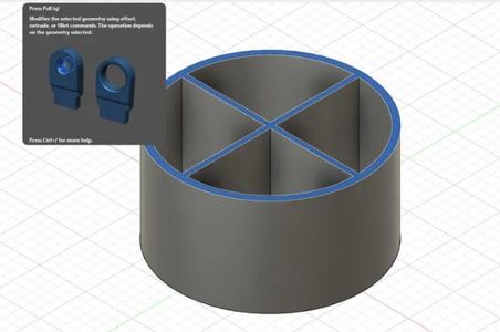

Step 3: Extrude the Compartments
Extrude the faces 50mm upwards.

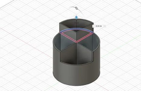

Step 4: Extrude Tiers at Different Heights
Redraw the same circles and lines on top of the extrusion. Select 3 of the parts to extrude, and extrude it upwards by 25mm. Repeat the extrusion for the third tier.

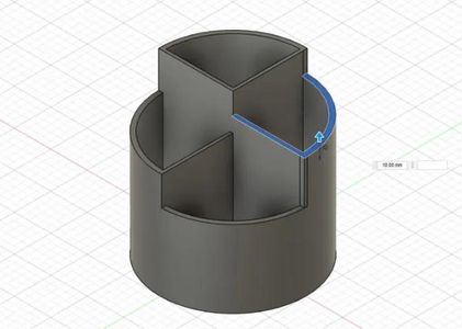

Step 5: Extrude Tiers at Different Heights
Extend the height of the tiers at different levels to balance out the final shape.
