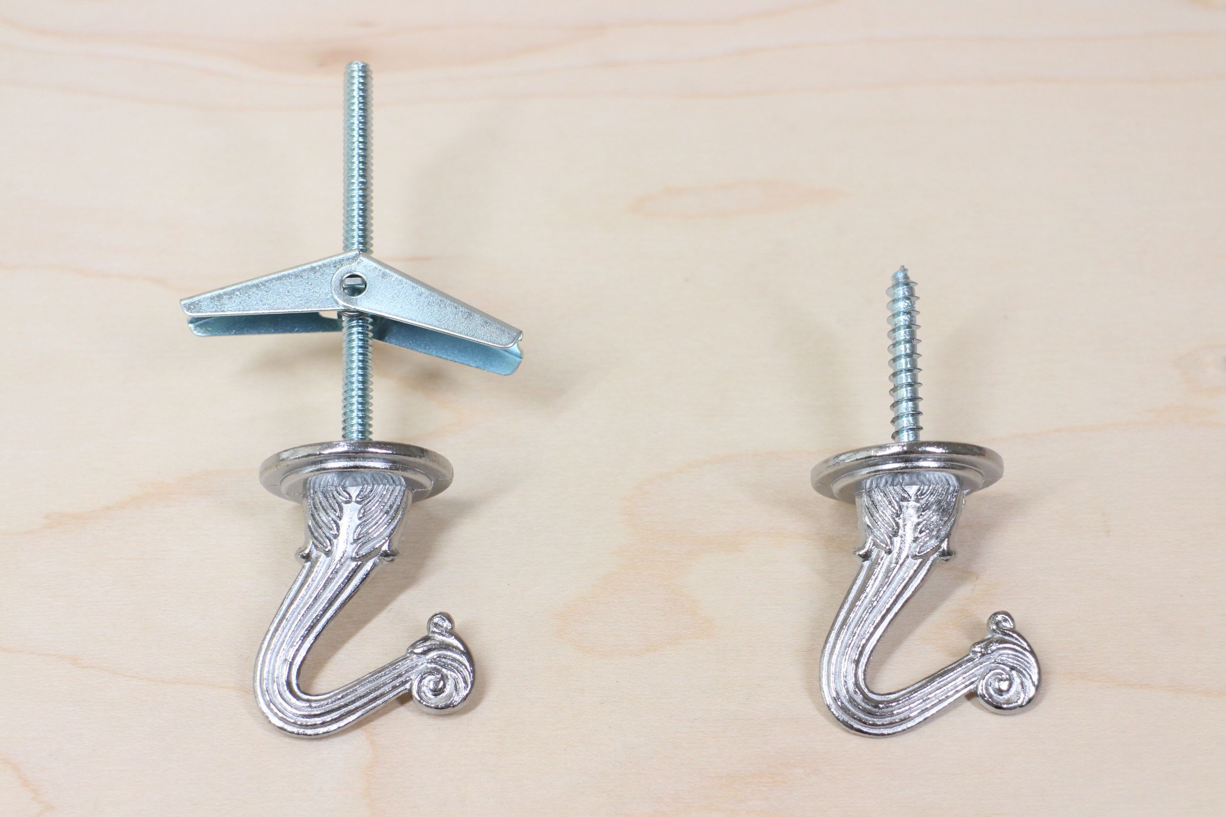

I recommend using a standard ceiling hook and a 'U' staple nail (or another cable wrangling piece of hardware). If you have a wood ceiling, you can use a simple screw-in hook (pictured below right), but if you have a drywall/sheetrock ceiling, use a hook with a toggle bolt (below left). The 'U' staple is to secure the cord into the corner of the wall and ceiling and help direct the cord towards the wall outlet.
(Left) Toggle Bolt Hook For Drywall Ceilings, (Right) Screw-In Hook For Wood Ceilings

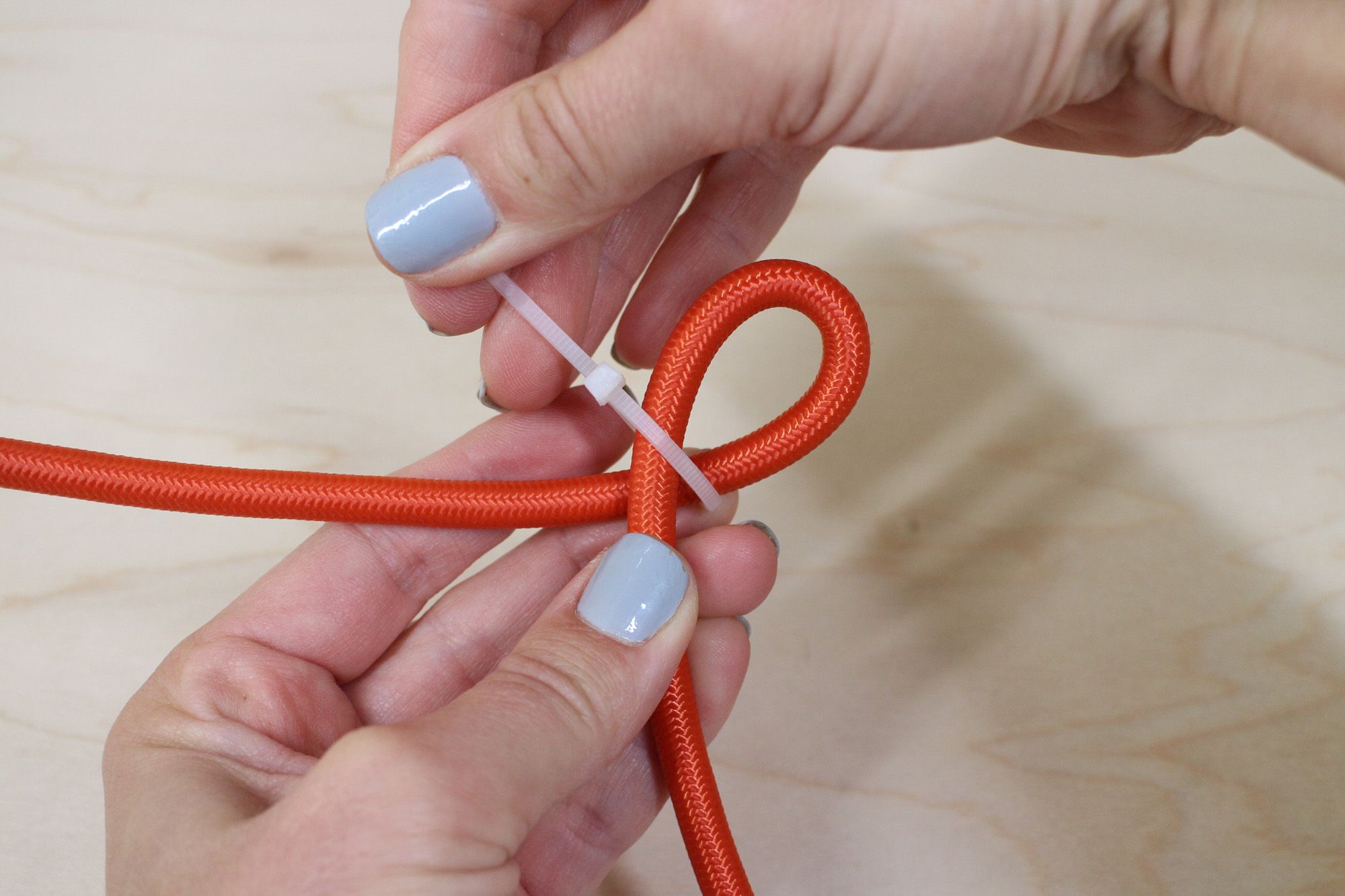

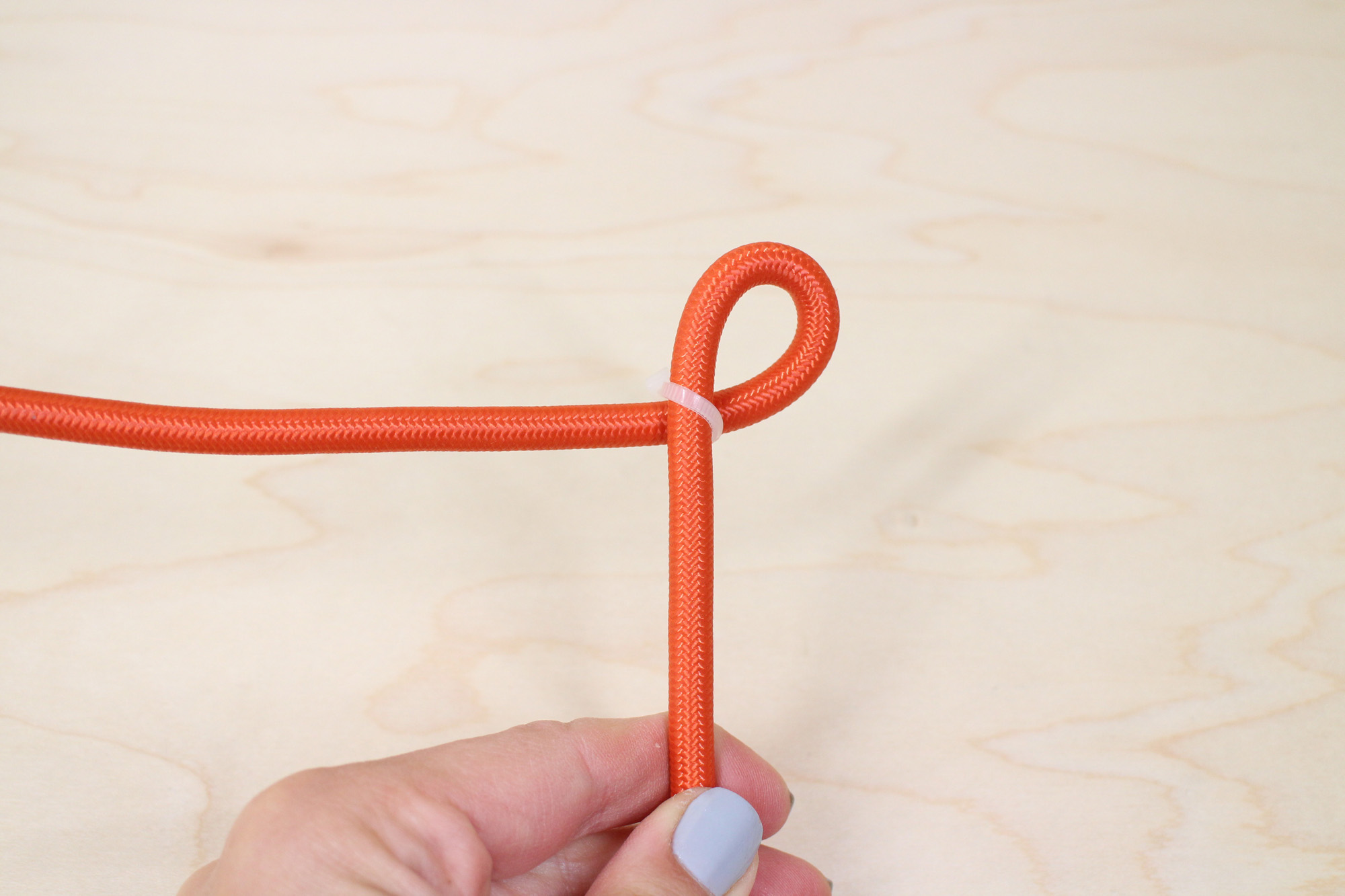

Once you have picked a spot, installed a hook, and figured out how high you want the pendant to hang, take a small zip tie and secure it around a small loop in the cord.
The great thing about using a zip tie is that you can leave it a little bit loose for minor height adjustments and then tighten it all the way up once you have the pendant exactly where you want it!

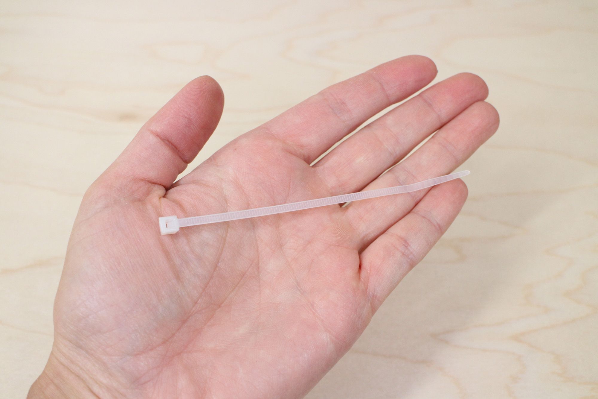

Step 1 - One zip tie, preferably a small one in whatever color will be most unnoticeable.
Step 2 - Make a small loop in the cord at the height you want the pendant to hang, minus the pendent depth measurement.
Step 3 - Put the zip tie around the overlapping area of the cord.
Step 4 - Tighten it so that you are still able to adjust the cord.
Step 5 - Once you've confirmed the height, snip off the excess zip tie.
Step 6 - Hang your pendant!
