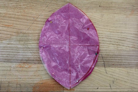

I started out this project with a pattern and slowly modified it over time. For the body pattern, I created a cross with the short side about 2/3 the length of the long side. I then joined the lines with a smooth arc. Basically, you want a leave shape.
Pro tip: Wax paper and sharpie is great for drafting your own pattern! The wax paper is super flexible on your fabric, translucent, and holds the marker well.

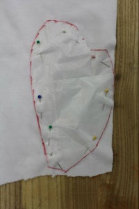

When you are happen when your pattern, transfer it over to your fabric. I'm using a fleece fabric, but really anything will do.

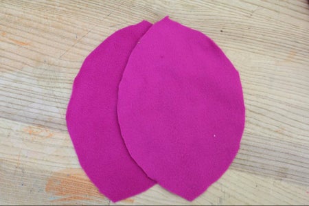

Pin your pattern on and cut out your shape around the edges. Do this three more times so you have four identical pink pieces.

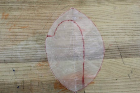

I took the pattern from step 2 and re-purposed it here, changing the shape to allow for my penguin to have a white belly!
Cut out a shape similar to what you see here and save both pieces of the pattern.

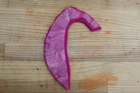

Pin the "outline" part of the pattern onto a pink fabric piece, and cut out around the edges. Flip the pattern over and do the same thing on another piece.
Then, take the second half of your pattern and pin it onto another piece/type of fabric. I'm using a white fleece fabric. Cut out your piece, flip the pattern, and repeat.
You should have two "outlines" in your base fabric and two "bodys" in your secondary fabric.
