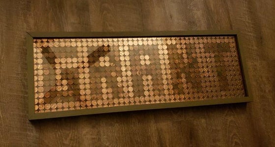

i made a penny name sign for my sister because she is a coin collector. and i thought it would be a cool looking sign.

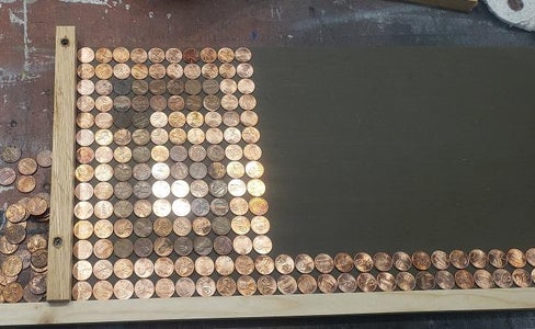

i then screwed wood to my bench on the bottom and one side. then on one corner i screwed a piece over a corner to hold it in place. this will kept your pennies straight and square.

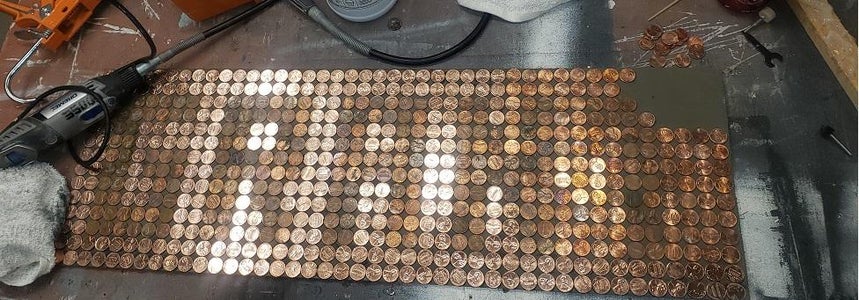

i used 100% silicone to attach the pennies to the board with a artist brush. once the silicone was set up i found the pennies had a sort of orange tarnish on them. so i used a metal polish (meguiars next gen. all metal polish) and my dremel tool to polish the pennies i cleaned. you could polish them before installing them also.

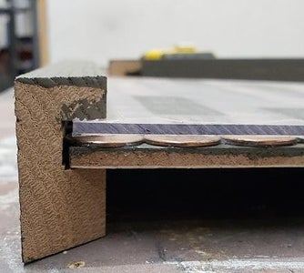

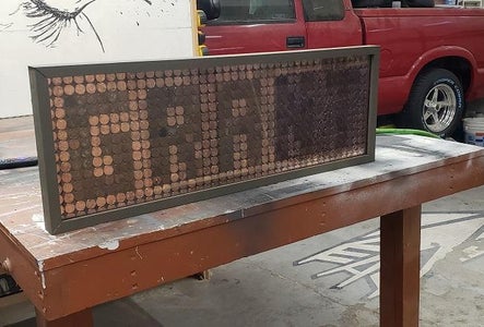

i cut my wood to 1-1/4"x3/4 i used oak because i had it let over but you could use the wood of your choice. i then ran the wood through the table saw cutting a 3/8"x3/8' grove 3/4" from the back edge of the wood. i then painted the wood cut the corners. then laid the lexan over the pennies and glued and nailed it together. i then added 2 pieces of 3/4"x1-1/2" 16" apart to help strengthening the sign and i will use those 2 pieces to attach the hanging hooks on.
Step 6: Then Your Done
buy some hooks or wire to attach to the back and hang it up.
