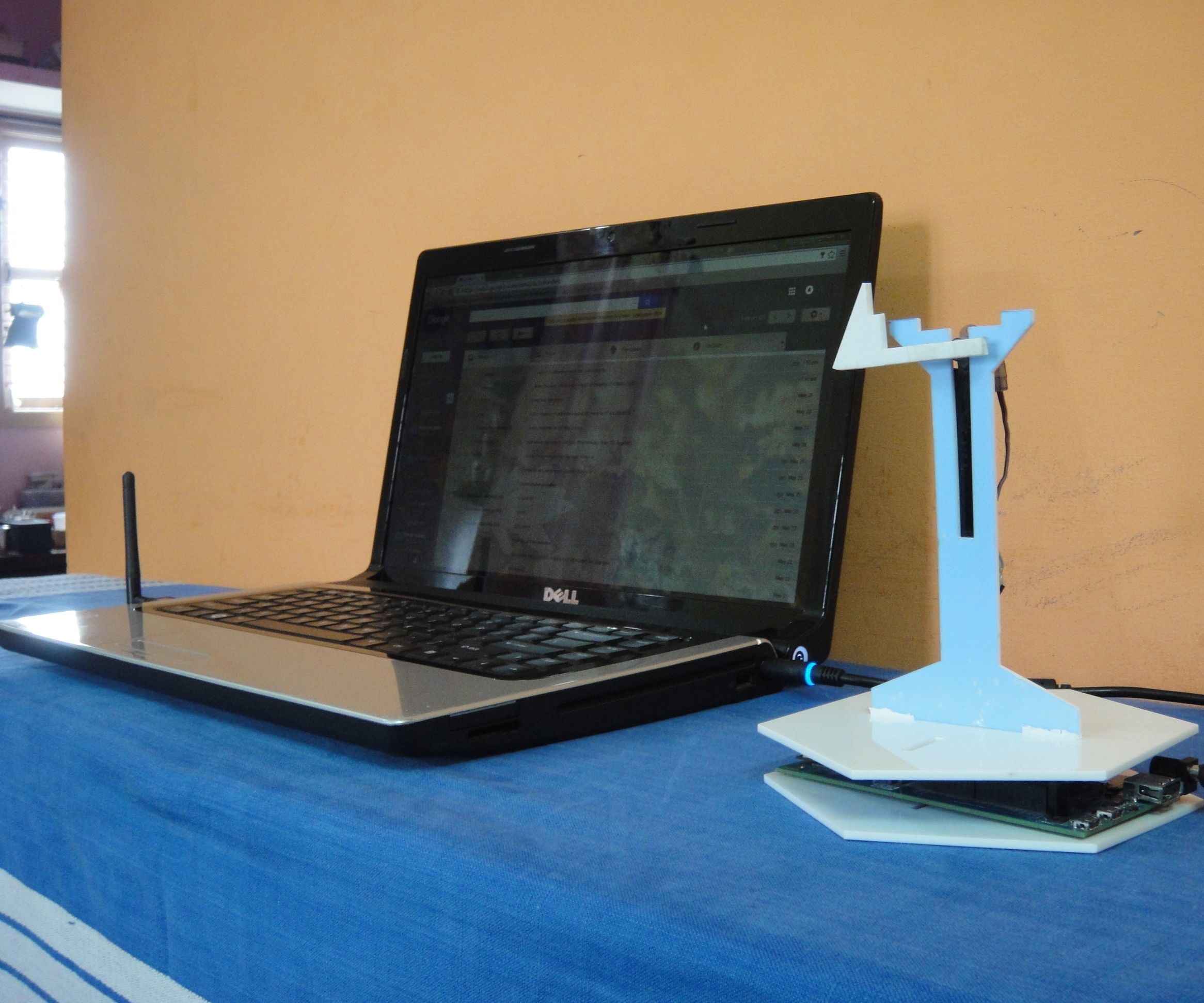

Introduction: Water ATM Using Intel Edison
In this project, we will see how to make a device which will exchange money for water.
This project is supported by BAL-IoTLAB(www.iotlab.in)
For this we are gonna use:
