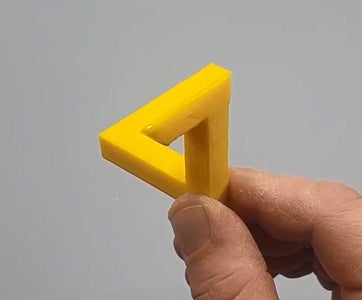

Although it is actually impossible to make the triangle as a solid object, you can get pretty close with your 3D printer. Of course it remains an optical illusion, but I still find it fascinating to look at it.

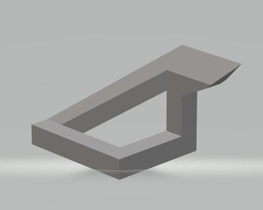

Step 1: Design

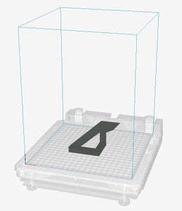

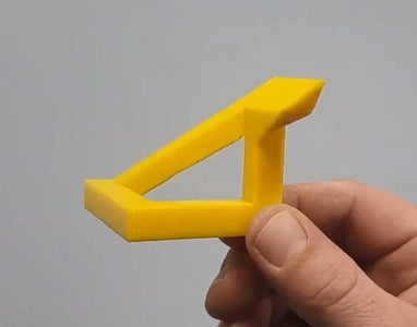

Drawing the object to print is the most work. Yet it only took me half an hour to do this. First I calculated an L shape with the same length on both sides. Then I drew an axis up on one of the corners. Then I rotated the image until I found the triangle shape. I then connected the axis up to the other end of the L shape. Finally I drew a protrusion on the axis upwards that falls exactly in front of the inside of the L shape. When the drawing is almost finished it becomes quite difficult to see it properly. Then you see a 3d object, then an impossible triangle and so on ...
I have added the drawing and the STL file in the attachments.

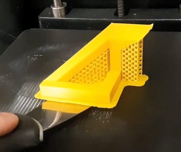

Step 2: Print

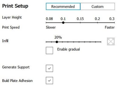

When printing, I chose to use a raft as a base. My print bed has been through a few things and has some uneven units. If you have a straight print bed, you can also do without raft.
I chose to use supports because I was not sure if it was necessary. In retrospect, I think the print would have been successful without supports.
Furthermore, I have used the prescribed settings for the printer with 20% fill in in a triangle shape.
The video shows a time-lapse of the print.
Step 3: Finishing

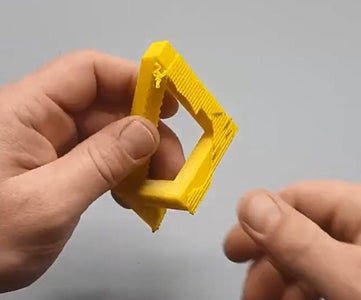

After printing I finished the print. To start with the raft taken off and the remains removed with a knife. The support broke off and the large remains also removed with a knife.
Finally, I finished the object with a piece of P240 sandpaper. Especially the tip of the protrusion must be finished completely straight.
To give it an even tighter finish, you can put it under a bucket with a bowl of acetone for a while. The plastic reacts to this, making the outer layer completely flat. Heating is also possible, but I am not a fan of this myself. The plastic is very fragile and if you touch it in a warm state, there is immediate damage.

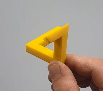

Ready! Now keep the tip of the protrusion exactly in the corner of the L shape ... I can keep looking at it!
