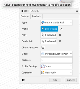

Step 4: Sweeping Sketch
Select the Sweep Tool:
- With your triangle sketch complete, navigate to the Create menu and select Sweep.
Set the Sweep Type to "Path" and "Guide Rail":
- In the sweep dialog box, change the sweep type to Path and Guide Rail.
- Select one of the curvy lines from your earlier sketch as the Path.
- Then, choose the other curvy line as the Guide Rail.
Ensure Perpendicular to Path is Enabled:
- In the sweep settings, make sure that Perpendicular to Path is selected. This keeps the triangles aligned perpendicular to the sweep direction as they move along the path.
If Needed, Change to Full Extents:
- If the sweep doesn’t work as expected with the current settings, change the option to Full Extents to ensure the entire triangle profile sweeps across the full length of the curves.
Complete the Sweep:
- Once the settings are configured correctly, confirm the operation. The triangles will now sweep along the curvy path, guided by the second curve, creating a flowing geometric extrusion that complements the overall design.
