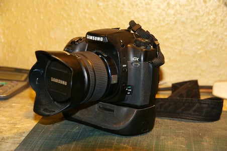

In the first image is the GX10 and the new battery grip.
On inspection the three mounting pillars (the silver metal locating pillars) are in the correct positions and the electrical contact socket and plug are also in correct alignment. What became immediately apparent was the fact that the edge moulding of the grip has raised areas to fit the K10D body, but the GX10 does not have these so the edge of the battery grip fouls the body of the camera. Luckily the bottom of the camera is flat.

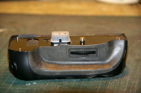

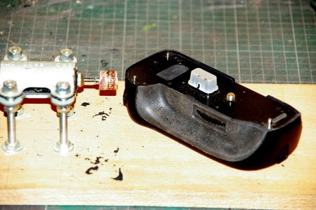

After lots of offering up and checking, it seems that these raised areas are the only thing preventing the grip from fitting. Since the battery grip body is ABS plastic it should be fairly simple to make the corrections. In the second and third images you can see these raised edges quite clearly, they simply need to be removed so that the edges follow a flat level pattern.

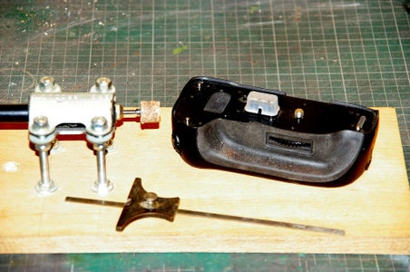

Using my Dremel with a drum sander and flexi-shaft, I mounted the shaft into my homemade stand (see my other Instructables for how the make one). Then using a depth gauge and a little trial and error I set the drum to correspond with the lowest edge. This proved to be the corner nearest the shutter release in my case.
The Dremel made very light work of sanding off the raised edges. The ABS sort of sand / melts and once cooled the excess plastic simply pulls away to leave a clean edge. It took less than a minute to remove the excess plastic.

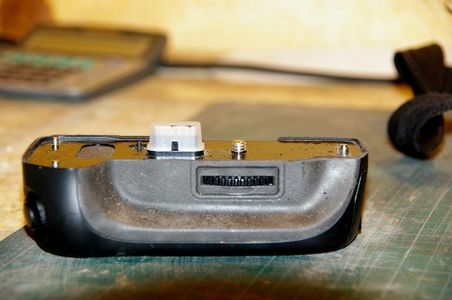

In the third image you can see all the raise edge material has gone. You may want to take off any sharp edges with a quick wipe over with some wet and dry paper.

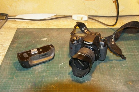

Once fitted, the body alignment is surprisingly good, certainly no worse than other far eastern after market grips 'dedicated' to certain cameras. All the functions (AF, shutter release etc) work as they should and the camera feel good in the hands.
