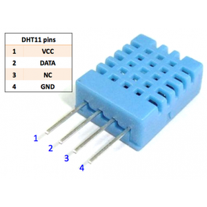

- 1 DHT11 Humidity and Temperature Sensor;

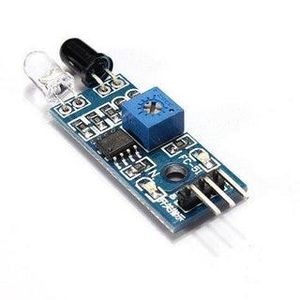

- 2 Infrared Reflective Obstacle Sensor.

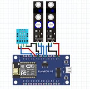

Step 2: Hardware - Setting Up the Circuit

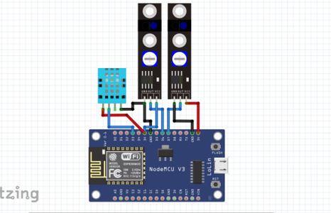

The circuit schematic can be found in the ContadorDePessoas.fzz file below. We used the Fritzing program to create it, and thus understand the connections in the protoboard. Mount it on a protoboard to test and if everything works correctly, make a PCB board for your circuit.

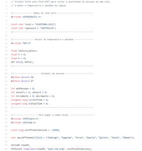

Step 4: Software - Explanation of the Code
For the project, we created 3 different codes.

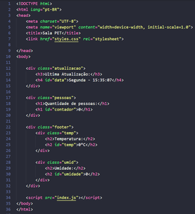

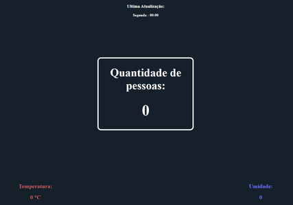

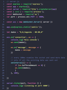

In the Frontend of the website we use HTML, JS and CSS. The application boils down to creating a page using pure HTML and CSS, where we will show the latest update of the website, number of people, temperature and humidity. JavaScript is used to communicate with Nodemcu, using socket.io and sending it to the page with .innerHTML.
For the Backend, some consts were used to create the server, with the installation of WebSocket and express. The wss.on function is aware of any connection on that server, if it occurs and the client sends a message, the ws.on ('message') function will be called. This message will be stored in the data variable. In the setInterval function, which is called every 100 ms, it will evaluate whether the new message is the same as the previous one, otherwise, it will send it to all connected clients, using the ws.send function.
Finally, we have the .ino code that controls the nodemcu. For this project, 5 libraries were used, namely:
- DHT.h - To use the temperature and humidity sensor.
- ESP8266WiFi.h - So that it can be possible to have a Wifi communication.
- WebSocketsClient.h - Responsible for communicating with the websocket.
- NTPCliente.h and WifiUdp.h - Responsible for taking the current time and showing when the last update was.
Initially some variables are created to store some important values for the course of the code. Some functions were created to manage these variables. One of them is the webSocketEvent function (WStype_t type, uint8_t * payload, size_t length), dedicated to receiving the value of the variables and sending it to the backend of the application.
And we have the functions void verificaAlteracaoData() and void contaPessoas() that will update the values of temperature, humidity and count of people.

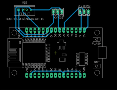

Step 5: Printed Circuit Board (PCB)
If everything has worked out so far, make a PCB board (we usually use EAGLE CAD software to do this) and then solder the components.
