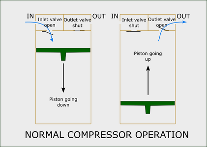

Air compressors pump air through in one direction, air inlet to air outlet. There are valves inside the compressor that ensure the airflow always goes in this direction. Check the diagram "compressor normal operation" to see how this works.

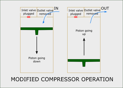

The massage effect happens when air is pumped into the cuff and then sucked back out of the cuff repeatedly and with force. We need to modify the air compressor to cycle air back and forward to the cuff. The second diagram shows the configuration of the compressor modified for massage duties.

The valves in the compressor are "reed" type valves. These are simply a thin piece of metal that flexes away from a seal when pressure is applied on the correct side. The reeds are either screwed or riveted inside the compressor. We need to remove all reed valves from the compressor. If the reeds are held in with screws, remove the screws and the reeds. If the reeds are riveted in place, just break the reed off. The reeds are very thin and snap off quite easily. There is no need to remove the rivet.
On one of my compressors the inlet valves were located in the piston. This makes no difference. The valves must be removed.
Next, we need to identify which valves are the air inlet. These holes must be blocked to prevent new air from entering the system. I recommend using grub screws to block the holes. You might also use rivets or bolts screws depending on your situation. The main thing to be careful of here is that the blocking materials do not intrude into the cylinder. Make sure the piston can't contact the bolts when it is at the top of the stroke.
The first photos show me using M8 bolts to block inlet holes on a larger (blue) compressor. A second set of photos shows a smaller (red) compressor that has inlet holes and valves built into the piston itself. The location of the inlet valves does not matter. They still need to be removed and blocked off.
To modify the piston valves, first remove cylinder body and cylinder liner. They simply lift out. Remove the reed valves from piston by lifting them up and snapping them off. I used M6x5mm grub screws to block the holes. I couldn't use bolts here. The bolt heads hit the cylinder head when the piston rose up to the top. Ask me how I know this. ;)
Make sure you use thread locking compound on any bolts or screws you install. These fasteners must not come loose and rattle around in the cylinder head.

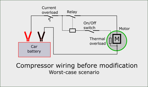

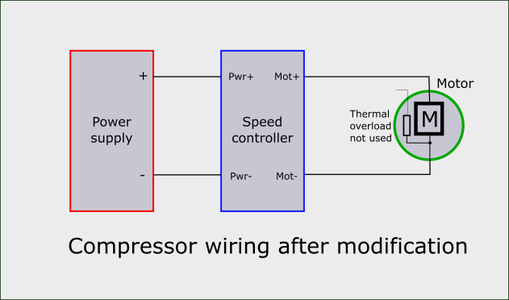

Most air compressors have a relay in the electrical input end. The main reason the manufacturer adds the relay is so that an expensive, high-current switch can be replaced with a small one and the cheap relay does the high-current switching instead.
The speed controller works by turning the DC current on and off very fast. The relay cannot handle this high speed switching. The relay must be removed from the compressor. All other devices such as switches, over-current and over-temperature devices will be redundant and should also be removed. The power supply and speed controller now perform over-current protection. The compressor will be running at much lower power than it normally would and there is no chance that the motor will overheat.

Your compressor needs to end up with only two wires coming out of the motor. The cover on the electrical end of the compressor should still be unattached, so let's get started.
First, remove the relay, the overload and the switch from the compressor. See the pictures to help you identify which device is what. If you need to cut wires, make sure the wires staying in the compressor are as long as possible.
There are three wires coming out of the motor on this large (blue) compressor. The two thicker ones are the positive and negative power. The thin wire is used for thermal overload. The thin wire is no longer needed.
Once the relay is removed, it is likely that you will need to join the power input wires to the motor power wires. I used insulated crimp connectors for this job. Soldering and heatshrink or tape is also fine. The current here is quite high and there is a lot of vibration, so I would avoid using wire nut connectors.

Step 7: Speed Control
Open the lid of the speed controller. My controller had a piece of white foam in the top of the lid. This foam is for packing purposes and it will restrict airflow. Remove and discard the foam.
Break off the locating tab from the potentiometer as shown in the photograph. The tab prevents the potentiometer from seating firmly against the inner wall of the case. Screw the potentiometer nut on so that the circuit board sits in the correct location inside the case.
If you have modified the power supply do these steps:
Work out where on the power supply you want to mount your speed controller. I mounted mine on the top right of the power supply. Drill the four screw holes using the circuit board as the template. I used 4G x 1/2" screws, so I used a 2.5mm drill bit for the screw holes. Drill all four holes and screw the speed controller temporarily onto the case.
Locate the two terminals on the speed controller for power supply input. Drill two holes adjacent to these terminals, one for the positive wire and one for the negative. Size these holes so that the wires are a snug fit. Drill the holes through the speed controller housing and through the power supply case.
Unscrew the speed controller and detach it from the power supply case. Choose a drill bit two sizes bigger than the one you used for the wires. Use this drill bit to enlarge the holes for the wires in the power supply case only. These larger holes ensure that the wires do not rub on the metal case of the power supply and damage the insulation.
Caution: Make sure you are connecting to the correct terminals on the speed controller. Reversed connections are likely to destroy the controller.
Run the power supply wires through the power supply case and into the speed controller. Connect the wires to the speed controller power input terminals.
Connect the compressor motor cables to the speed controller motor terminals. Screw the speed controller down onto the power supply case and tidy the wiring. I used a zip tie on the inside of the case to help relieve strain on the motor cable terminals. Put the lid on the speed controller case, tighten the nut on the potentiometer and push the knob onto the pot.
If you have NOT modified the power supply do these steps:
Drill holes in the speed controller case to accommodate the power supply wires and the compressor wires.
Find the battery clips at the end of the compressor cable. Mark the positive wire with some red tape or similar. Cut the battery clips off the cable. Cut an extra piece at least 200mm (8") long from both wires. Connect these wires from the power supply output terminals to the power input terminals of the speed controller.
Connect the compressor motor cables to the speed controller motor terminals. I used a zip tie on the inside of the case to help relieve strain on the motor cable terminals. Put the lid on the speed controller case, tighten the nut on the potentiometer and push the knob onto the pot.
Everybody does this:
You're now ready to power up the compressor and try out the speed control. Does it all work properly? Good!
