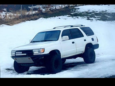

The purpose for this series of instructions is to learn the basics of performing an engine oil change on a vehicle. Vehicle ownership incurs maintenance and operating costs where drivers have the potential to save money, and develop a new skill by performing ones own routine maintenance. These instructions serve as a step-by-step guide, accompanied by images, for performing an engine oil change. Most tools, equipment, and oil and be found at most major retailers and auto repair facilities that sell automotive parts and services.
The following steps will be applied to doing an oil change on a 1997 Toyota 4Runner.
