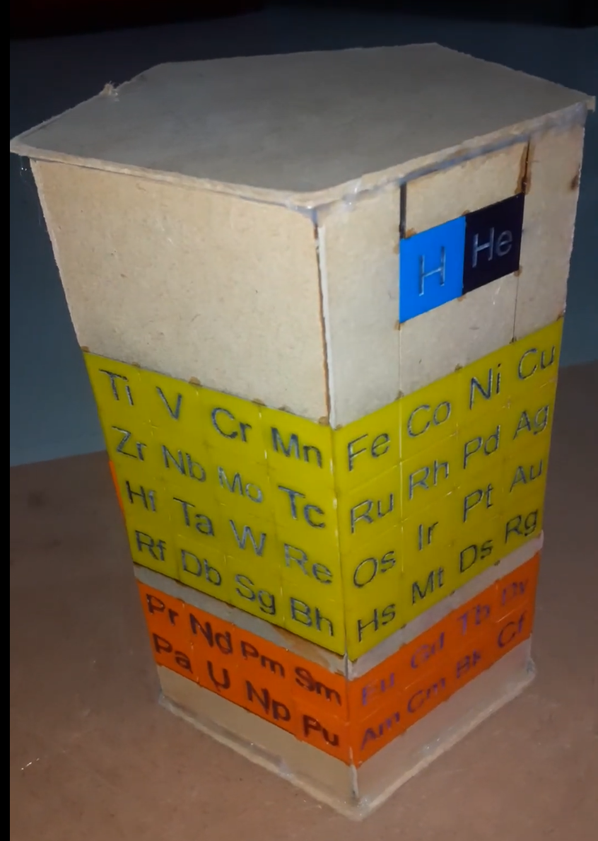

Assumption: I place Helium near Hydrogen because I don't have more space left on top of the noble gas column.

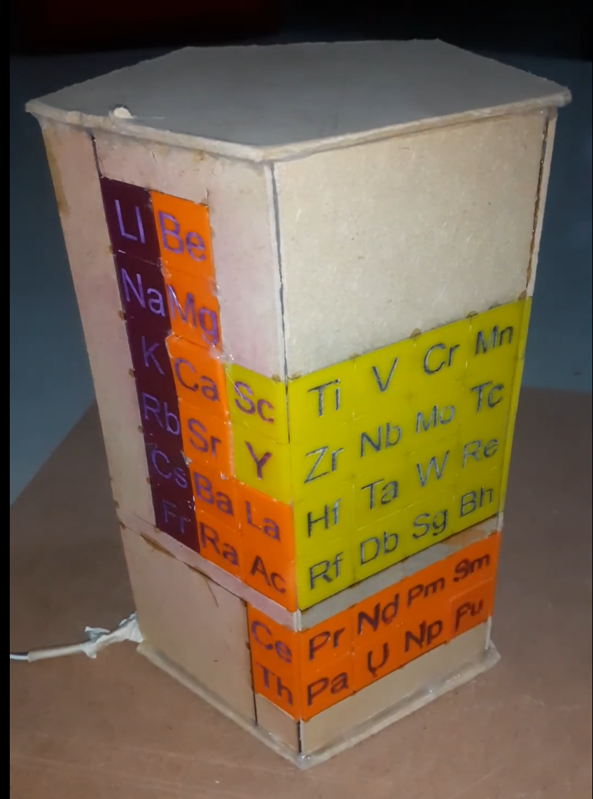

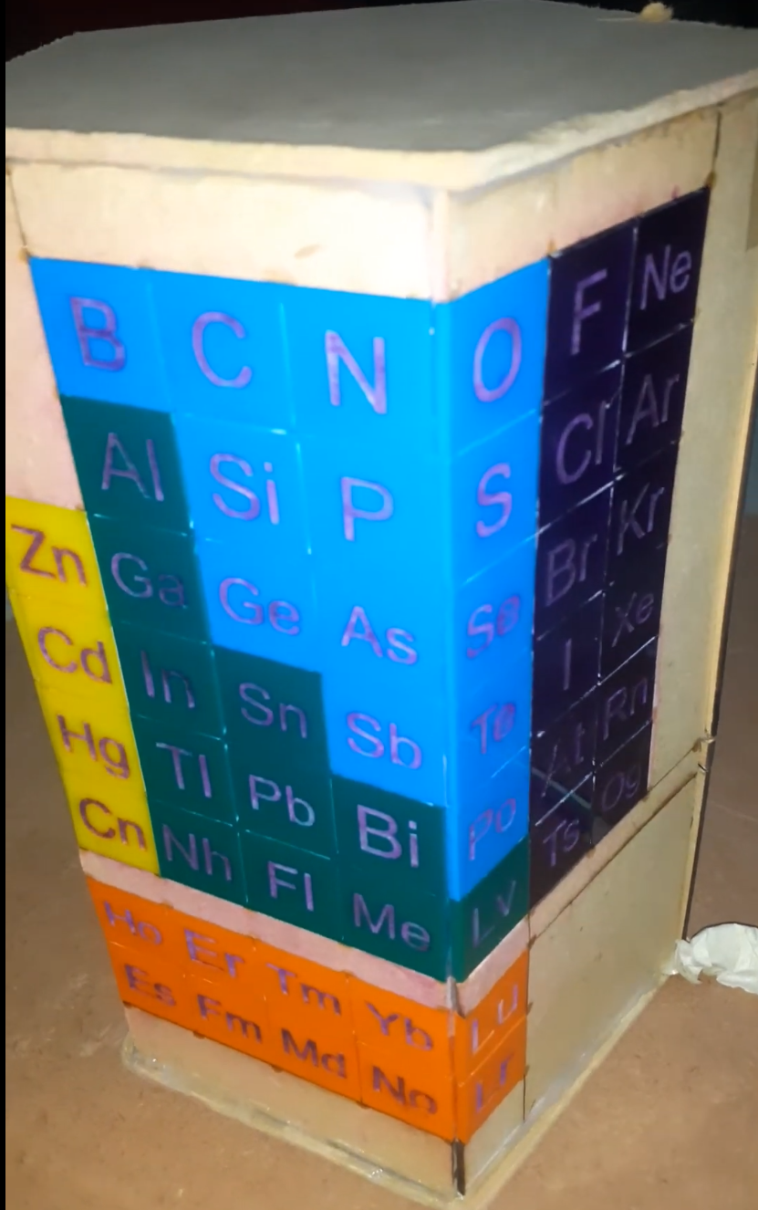

  • For assembly, I separate all elements into their respective group and place elements as per the periodic table.
  • Joint all similar squares by using a Glue gun in a Periodic table manner.
  • After joining an individual group, I join them on clear acrylic.
  • Now we have 5 pieces with elements stuck on the top surface of the acrylic.
Step 5: Assembly of Part 2
  • We place them on the pentagon side by side and stick with the pentagon.
  • Now we have Pentagon shape periodic table lamp ready.

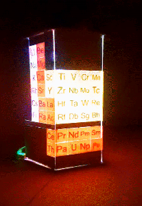

Step 6: Lighting.
For lighting, we use a Simple White LED strip or RGB LED strip.
I Use an RGB LED strip to illuminate the Night lamp from inside.
I use a triangle board to wrap an LED strip around it.
Attach a triangle to the bottom pentagon.
Place lamp outer part on bottom pentagon nad seal with Glue gun.
Step 7: Result
Attach the adaptor on the switchboard and switch it on.
WOOOOOW.
It's light it up.
You have a Periodic table lamp ready for use as a desk night lamp in your room.
