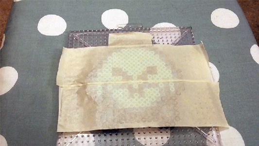

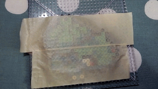

Masking tape method: Using masking tape to remove your perler creations from the plastic boards before applying heat, in order to prevent the boards from warping. the boards are relativily cheep, but I didn't like replacing them regularly. this instructable ins't about how to use perlers (see Fylke's instructable: https://www.instructables.com/id/Urban-artwork-usin...) or how to do the masking tape method (see attached youtube video. It's a very well done video made by the hard core perler - you should check out his website, he is one of my favorites - http://hardcoreperler.com/)- . There are several instructional videos that I find are more detailed than what I could produce. Instead I chose to focus of fixing a rather annoying issue of using the Masking tape method - The very time consuming effort of puncturing holes to let the expanding gases be released. By making a stamp that puncture 49 holes at once I could do a large art piece that used to take me an hour to punch the holes in the back, in matter of minutes.

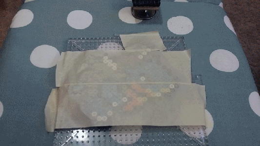

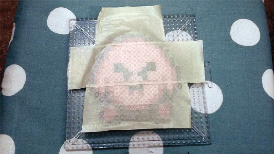

Melting process: after I apply masking tape to the back of my desired design, I use my stamp to poke holes in the back of the tape, then remove from the boards, and then cover with parchment paper. (you can use wax paper but it leaves a texture behind.) Any clothes iron will work. set the temperature to 2 - 3 (or low - medium low). move Iron in a circular motion until beads are consistently melted.

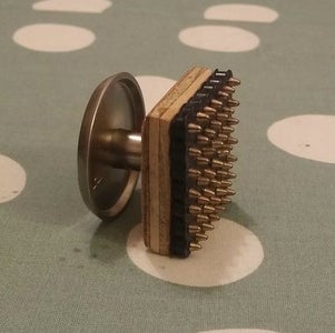

Step 5: Glue All the Things
take the pen tips and insert them in to the perler square. I added a tiny amount of gorilla glue to ensure they wouldn't come out.... don't over do it as gorilla glue does expand.... less is more.
after glue the perler square to the wood/drawer knob. You will want to clamp. I used the wood I cut scrap from to protect the pen tips.
wait 24 hours for the glue to dry before use.
Step 6: Final Thoughts
After 24 hours, you can use your perler stamp. It drastically cuts down on my time poking holes.
