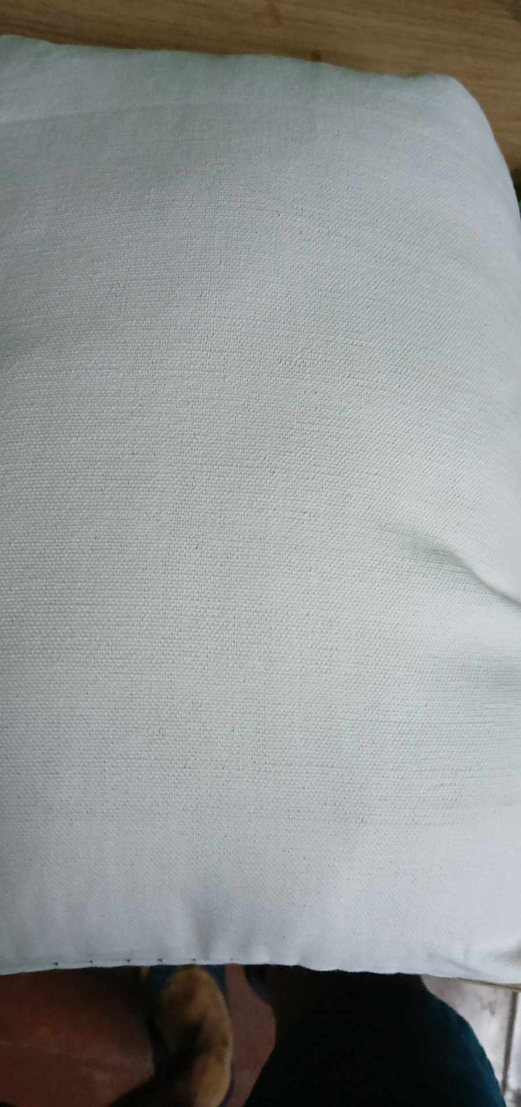

Step 2: Creating the Pillow
Now that you have the base of the bag prepared and some of your cloth attached, you can start on the pillow part.
First, do partially complete pillow. Sew everything together except for one side. Ideally, you probably want to leave the top open but I personally I left the right side open. Now align the bag such that the open side is facing up to make it easier to stuff, then drop in as much filling as you'd want. Not too much though as this'd make the bag hard. Try squishing it while you're at it to gauge how filled it was and whether it was getting too hard. If you put too little though, the bag won't have much shape and there'd be nothing to hug and squish.
