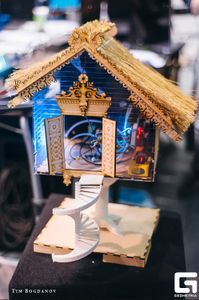

Rotation mechanism is implemented with the motor and gears.The main gear is fixed on a stationary support (the leg), through the bearing this gear connects with the floor of the hut. The engine is mounted into the floor. Power of the motor is 12 volts. Centering axis was used for combining this mechanism together.
INTERFACE
In the prototyping stage we decided to limit interactivity of the house with the audio interface.
The interface consists of Intel Galilleo board,which governs the motor, n coder, Hall's sensor,voice module Easy VR2.0.
The scenario of Interaction between user and the moke up :
The hut rotates because of module Easy VR 2.0, which has the microphone and commands which was wrote down by programmer. It reacts only on them.
CONSTRACTION
We used the groove system and screws for connection all parts together.
DESIGN
From architectural point of view a style of the hut is close to postmodernism with elements of old Russian woodcarving.
Step 3: Mechanism of Rotation
The construction of the model is fixed on the central axis which is passing through the center of the house and extending into the support on the frame rests on a thrust bearing. It lies between the main gear and the base frame.
The basis of the rotary mechanism is the large static gear which was fixed on the basis (leg) through the intermediate gear (5 times smaller than the largest). Gear shift mechanism is connected to the engine and gears of the manual control mechanism, which open onto the facade of the hut due to the angular gear.
The engine is equipped with a rotor that allows to connect directly a rotation mechanism, ease of manual control is achieved through the transmission gears on the facade.The hut rotates with a DC motor at 12 volts.
We used InkScape, CoralDraw, AutoCad and 3ds MAX to draw structure of the hut in vector form. Previews obtained were cut with a laser. The calculation of gear mechanism was made via
http://woodgears.ca/gear_cutting/template.html site.
Gear previews were edited in the vector editor and produced on a laser machine. Pillow block bearings were mounted in the mechanism and it was connected with the motor plus Intel Gallileo and N-coder.

Step 5: Construction of the Moke Up and Design
MATERIALES USED FOR THE MOKE UP:
-plywood (gears, walls, window)
-plastic PLA ( stair and leg were printed by 3d printer)
-transparent acrylic plastic (walls)
-different tools and hardware
MACHINES
- Leg and stair by 3D-printer MaketBot Replicator Dual
-Laser cutting by StepDir Laser 100W
We used the groove system and skrews from the construction of 3d printer for connection all parts together without glue.
