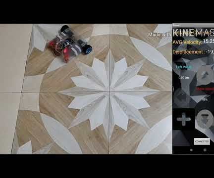

Step 6: Time for Code
I am leaving a download link for the code whereas I will also explain the basic algorithm behind the code.
- at first, the bot will initiate a search function for the hand.
- as soon as an object is found, the bot will initiate the loop function
- in that, if the left IR sensor is triggered, the bot will turn right
- if the right IR sensor is triggered, the bot will turn left
- if object comes too close, the bot will go backward.
- if the object goes far away, the bot will go forward.
