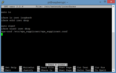

Editing the Network Interfaces Files
  1. Type sudo nano /etc/network/interfaces in the command prompt. Replace the code with the following:
auto lo
iface lo inet loopback
iface eth0 inet dhcp
auto wlan0
iface wlan0 inet dhcp
