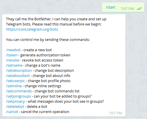

After starting a conversation with BotFather it will send the available commands to talk interact with BotFather. Because we want to create a bot let’s go ahead and send:
“/newbot” As you can see in the image below, BotFather will require some information about our bot. (1) How the bot will be called and (2) what is the bot username.
If everything worked well, the new bot was born. The bot is mainly ready to send and receive messages from the bot.
