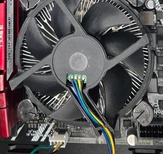

Step 4: Attach Heatsink
screw down the heatsink and be careful it is fragile.

Step 12: Attach Fans
connect the three fans to the fan outputs.
