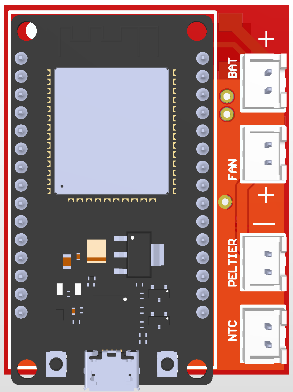

Step 1: Make Electronics
The whole device will work according to this schematic.
The Gerber files for the PCB ordering are provided on my Github -> Electronics -> PCB Gerber -> PCBv2.zip
PCBs can be ordered via many manufacturers like JLCPCB, PCBWay etc. For the JLCPCB - just drag-and-drop PCBv2.zip file onto their website and make an order.
Now solder components onto the PCB according to the schematics and photos provided - you can leave R1, R2, R3, C1, C2 and J3 unpopulated (you don`t have to solder those components). The device still will work as intended.
First start soldering smaller components, then go to the bigger ones, and as very last solder the connectors/screw terminals.
Solder together both pads (make solder bridge) of the SW1, or if you like, you can connect the small switch onto those two pads.
Instead of 2 pin JST XH connectors which are shown on the photos of the PCB as well as on the schematic (J1, J2, J3 and J4) you can use 2 pin screw terminals with 2.5mm pitch.
Instead of soldering ESP32 onto the PCB directly, solder female pin header onto the PCB, then just plug ESP32 into the slot (be aware of the orientation and pinout).
When you are finished with the soldering, connect the USB-A (two wire) to the J1 (marked BAT on the PCB in the top right corner according to the photo) make sure to match the polarity correctly - the positive wire goes to the '+' pad marked on the PCB. If the polarity is reversed, the device will not function (it won't be damaged, but it won't work either).
Now connect that USB-A connector to your phone charger/powerbank/laptop with appropriate cable (USB-C to USB-A or USB-A to USB-A - depends on which charger you use). Would be preferred that source have 2A or more of current capability.
If the ESP32 lights up, flashes, or gives any sign of life — it’s alive and functioning!

Second, attach the heatsink to the Peltier element, making sure to correctly identify the hot and cold sides of the Peltier. Usually, the hot side is the one with the module's label, but you should always double-check before assembling. To verify the cold side, carefully hold your fingers on both sides of the Peltier first, then briefly apply a low voltage (around 5V) and feel which side cools down. The test should not last longer than a few seconds (about 5 seconds) to avoid damaging the Peltier. Place the hot side of the Peltier against the heatsink, ensuring the heatsink fins are oriented as shown in the picture - in the way that fins are not blocking the air to exit thru the front part of the main case, so that air can flow freely and efficiently remove heat from the heatsink. Also, be careful not to leave the cables too long.
Third, insert the assembled Peltier element and heatsink into the case from the bottom side. Use the two small slots ("teeth") on the bottom of the case to guide the Peltier wires through to the electronics compartment. These slots will also help hold the assembly in place inside the case. Additionally, it is recommended to apply a few drops of super glue between the Peltier and the heatsink, on the edge farthest from the electronics compartment. Also, apply a few drops of super glue between the heatsink and the case (again, on that farthest edge) to secure the heatsink to the enclosure. All of this should be done from the bottom side of the case.
Make sure that the Peltier module protrudes 1–2 mm below the case, as shown in the photo, to ensure good contact with the user’s skin later.
Fourth, place the soldered PCB into the electronics compartment. Make sure to route the USB-to-two-wire cable through the small window on the door part. It’s usually necessary to thread the wires through the window first so that the USB connector stays outside the case.
Then, connect the Peltier and the fan to the PCB as labeled:
  1. The fan goes to the second connector from the top (positive pin is marked with a + sign on the PCB, as seen in the “Make Electronics” section),
  2. The Peltier goes to the third connector from the top, negative pin is marked with a sign.
Negative wire is black wire on the Peltier and fan, and positive wire is the red one.
