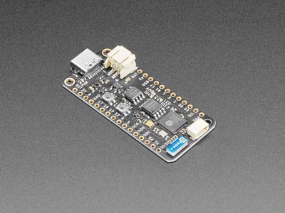

  1. FeatherS2 Board (headers come with packaging)

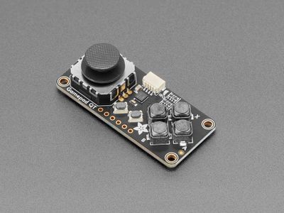

  3. Mini I2C Gamepad

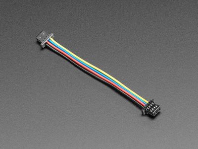

  4. I2C Cable 50 mm

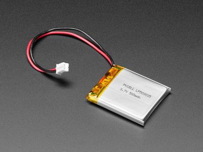

  5. LiPo Battery

One of the really cool features of the FeatherS2 board is that it comes pre-installed with CircuitPython! So all you have to do is connect the board to your computer with the USB-C cable, and upload the code file provided below! Be sure to rename it as "code.py".

Step 2: Solder Board + Attach to FeatherWing
Next, you will have to solder the headers to the board. I highly recommend following this Adafruit tutorial as well as watching this video they published.
After soldering, your board should look something like mine above. I did not do the best job 😅 but it ended up being serviceable, so you can do it!
Then attach the board to the FeatherWing, as shown in the photo above.

Step 4: Screw-In Gamepad
Connect the I2C cable to the game pad.
Then, resting the game pad in the bottom slot of the case front, use the 4 M2 screws as well as its respective nuts to secure it. Thread the cable through the opening.
Notice that the square cut out leaves room for the pins at the bottom!

You can also now connect the I2C cable to the board, as shown in the picture.

Step 9: Attach LiPo Battery
Using double-sided tape, tape the battery to the lower-center of the back board.
If the wire is being difficult, bend and massage it until the battery sits comfortably.
Then, plug the LiPo battery into the power port, as shown in the photo above.
