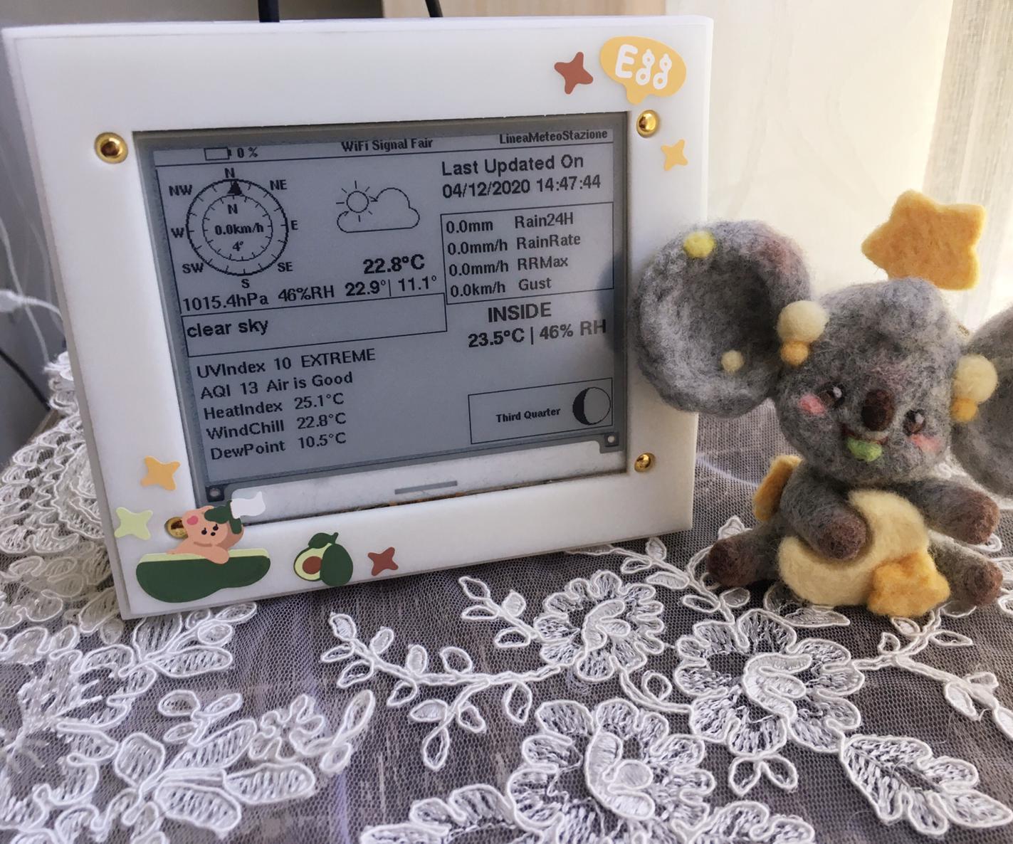

3. DEVICE 3: EZSBC BAT PRO ESP32 + PCB designed + INK Display + BME680
This is the part that just handles the visualization of the data on the display and it has also a sensor that monitors the air quality, temperature and humidity.
The display used is a 4.2 Inch ink display, which can be used as a WaweShare or GoodDisplay brand.
The case
is inspired by:
Box for ePaper + ESP32 Information Display by sidoh10 - Thingiverse
