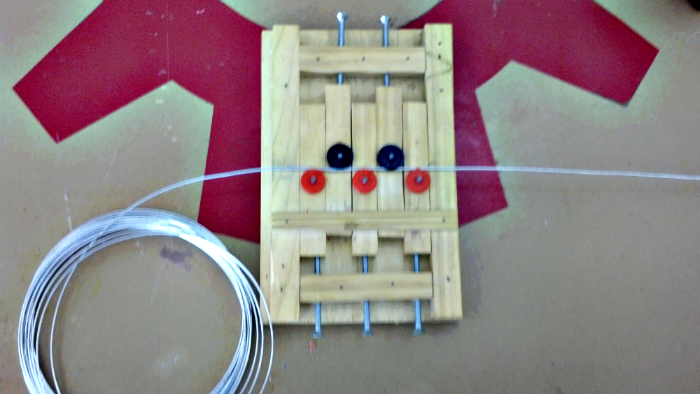

Start by straightening at lease 5 feet of wire, and cutting if free from the coil. That seems like a lot of wire, but trust me... you'd rather have too much than run short at the end.
