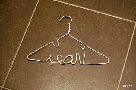

As you've guessed by now, my son is named Sean.
This hanger on the picture was my first one, in the meantime, I've improved my "n" and "s".

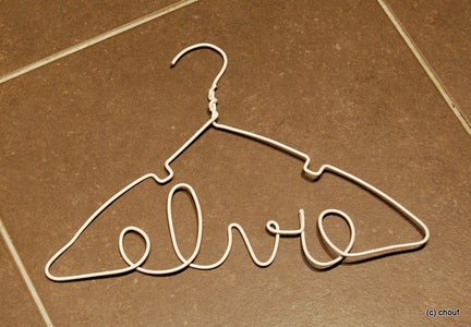

EDIT 04/08 - I made another hanger tonight for a little girl named elvie. Here's the picture

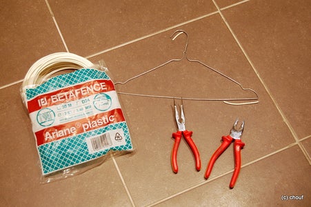

Pliers
I used two different type of pliers. The bigger one to make the sharp angles and to pinch the wire so it'd stay in place. And the thinner one to make the little curls. Usually these type of pliers can cut the wire too. If it's not the case for you, you'll obviously need cutting pliers.

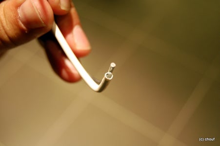

In the nearest DIY shop they didn't have the same type of wire like normally used for wire hangers. It was either too thin or too thick. I've finally found a white fence wire coated with PVC. It's actually meant to be used as a drying line in the garden. The wire has a section of 3.2mm which is very thick. I'd recommend to take a wire 2.5mm thick max. It'll still provide enough stability so your hanger will be solid while give your more flexibility to make nice letters and curl the wire the way you want. With my 3.2mm one it was not easy to bend the wire and make nice round letters.

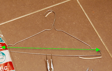

You can see on the picture below the thickness difference between my white coated PVC wire and the standard wire hanger
A standard wire hanger
I used a standard wire hanger as a template to have an idea of the measurement or a normal hanger. While making my hanger, I often put it on top of the template to compare the size, angles and so on...

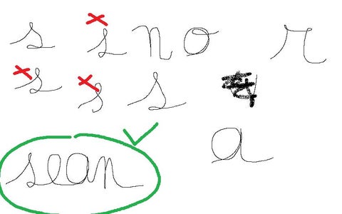

You can compare"writing" the name with a wire to writing in cursive letters; your pen cannot leave the sheet and you have to write the entire word in one go with a continuous line.
In order to have a good result, I drew some examples on a sheet of paper in order to have a clear idea on how I was going to make each letter. I highly recommend you to do the same, it only takes a minute or two and will make your life easier when bending the wire.
Things to consider when you draw your model:
- do not lift your pen off the sheet of paper
- draw the hook too so you can centre the word (best is to have +/- the same amount of letters on each side of the hook). Not only it's more pleasing to the eye, but it'll also ensure your hanger doesn't tilt on one side

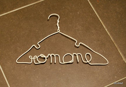

Once you have a clear idea on how to proceed, cut a piece of wire so you're not annoyed with the reel. For the length of wire to cut, I used the flat part of my template hanger as measurement unit. To give you an idea, I used 4x the length for the "sean" hanger and 5x for the "romane" one (btw "romane" is a French name for a little girl). So it's +/- 170cm for the sean one and +/- 200cm for the romane one.

As you'll have guessed while drawing the word in your notebook; for some letters you'll have to make several pass that will have to overlap each other. One thing I've learned when making the hanger is to think in 3D. Your wire doesn't have to remain like on a sheet of paper anymore. If you look at the picture below; for the "M" of romane, I've bent the wire to the back (like if it would enter the sheet of paper) to go back up. The result is nicer.
Don't forget to measure your hanger on a regular basis so you 'll get something +/- standard that can fit most wardrobes. As I said, I was simply putting my hanger on top of the template one just to compare.
