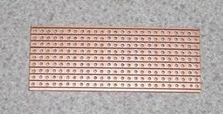

5.Veroboard

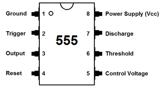

Step 2: Circuit Diagram
In this instructables we use the NE555 IC that can generate both pulse and frequency.This ic is also cost effective.To build this circuit follow the circuit diagram with the specific value.In top i use 150 ohm and 100 ohm and 0.1uF capacitor that can generate 42 khz frequency that can repell the mosquito.But u can also use different value for different pests.

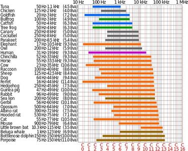

Step 3: Different Frequency for Different Pests
Here some of the frequency range,in which pest can be repelled.Follow this frequency range and replace your resistance and capacitance value.
