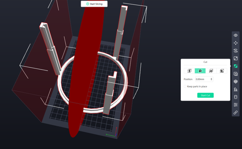

Step 3: Bowl Size Too Big?
If your bowl size is too big to fit the model on the printer, you will have to slice the model in half and print two parts, then use Superglue or Loctite to secure them together after both pieces are printed.
